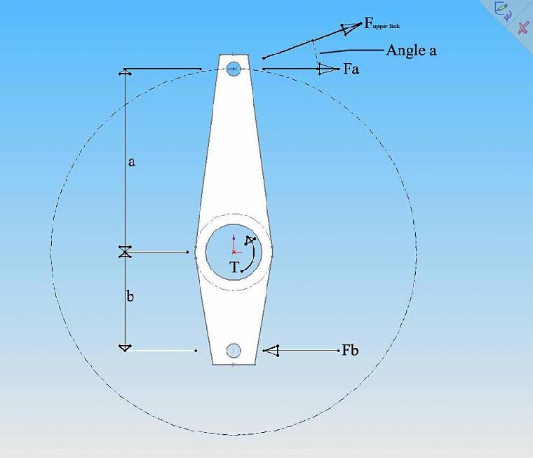

To find the force in the link due to axle torque, you need to know the torque output and the distance between the links.
Any engineers or engineering students here?
This is assuming a worst case scenario of having the tire trapped, or unable to turn, so that all of the torque goes into trying to spin the housing. It also assumes full throttle.... From the pic above:
Fa = T/(a+b)
Fb = T/(a+b)
Those equations above come from a simple supported beam (the bracket) with a moment load (axle torque) applied somewhere between the supports (the links)
Keep in mind that this assumes that the link is tangential to the torque moment. Since this is an off road truck, the axle is surely going to be below the frame mounts for the links. This means that for the same torque moment, the force on the link will change as the suspension cycles from droop to compression. If the link is at an angle away from tangential, then the force in the link will be the tangential force divided by the cosine of the angle. In the case of my drawing, the force on the upper link is:
Fupperlink = Fa/cos(Angle a)
The same procedure can be applied to the lower link.
Once you have the force, simple divide by the cross sectional area of the tube.

Fupper = T/((a+b)*cos(a)) = 66,000/((8+2.5)*cos(5)) = 6309 lbf
Stress = F/area = 6309/1.914 = 3296 psi
Since the critical buckling load for this link is:
Fcr = (pi^2*E*A)/(l/k)^2 = (3.14159^2*29,700,000*1.914)/(48/0.5896)^2 = 84,676 lbf
This will give you a factor of safety for this load of around 25.7. Axle torque isn't going to buckle a link here.
If the links are parallel, then they will have equal and opposite forces applied to them. If they are not parallel, then the forces will not be the same because of the different angles between the link and tangential.
If the brackets are going to sweep forward slightly, this will increase the forces in the links and decrease the bending forces on the actual bracket itself because of the associated increase of <Angle a> in the image above.
