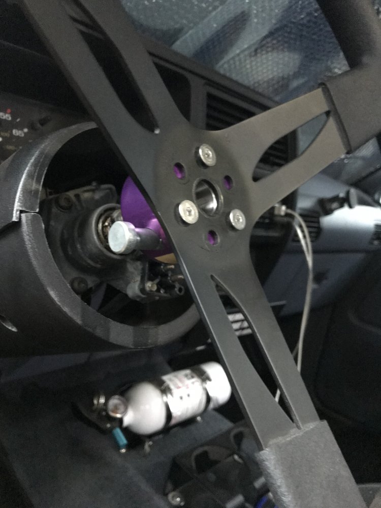

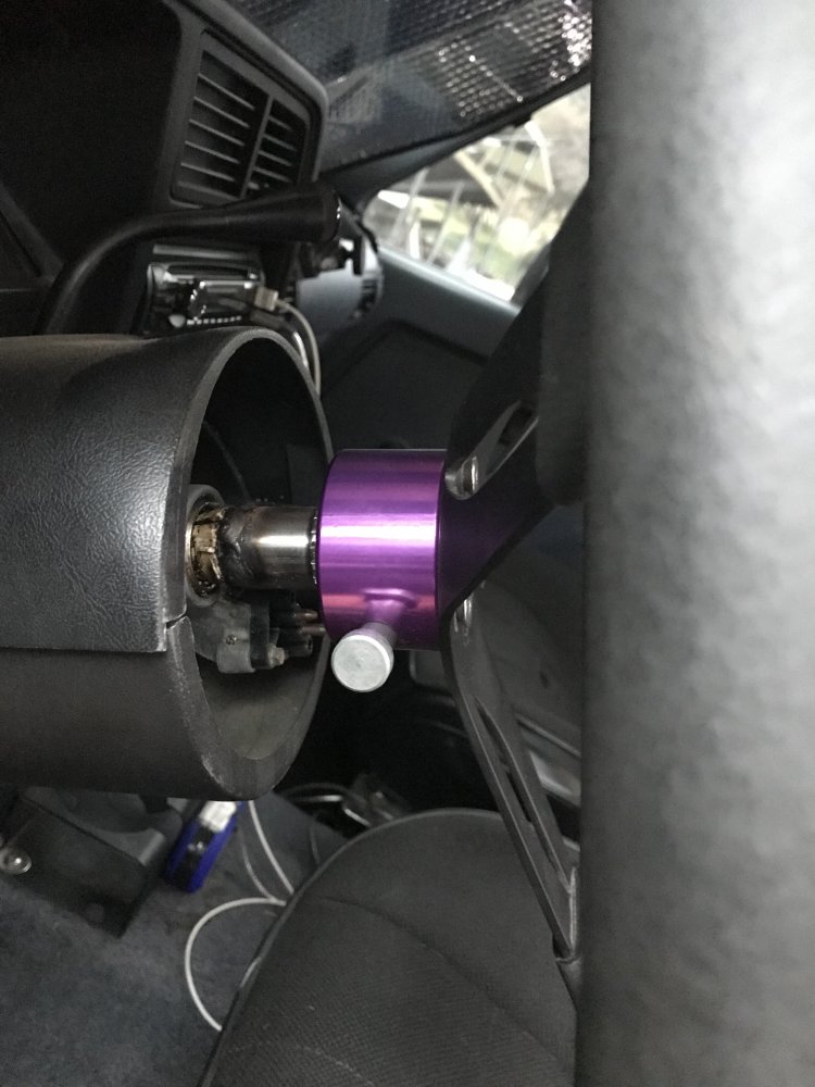

In Southern California older Ford trucks are common targets for theft, mainly because they’re not hard to break into, but also because they’re easy to offload/strip for parts especially if you’re in close proximity to the border like I am. Rangers, especially modified ones get stolen and stripped down stateside or taken across the border here on an almost regular basis. Anywho, this is my solution to the problem. I just take my steering wheel inside with me
So, no one else could buy a wheel to fit that hub? Or clamp a big pair of Vise Grips onto it?
I'm glad I live where I don't have to stress about stuff like this. If I go to the hardware store in town there's always a line of vehicles parked in front, probably half have the keys in them. I don't leave my key but I also don't lock the doors.
They could, it’s actually the hub they would have to try and match up though, not the wheel. I mainly installed this because having fixed-back suspension seats makes ingress and egress a little more difficult with the steering wheel in the way, but it makes for some nice extra piece of mind. Also it’s never parked anywhere in town long enough for someone to try and match up the hub, and I live in a rural area in the mountains on acreage with a locked gate.. so no one can get a good look at it there either
