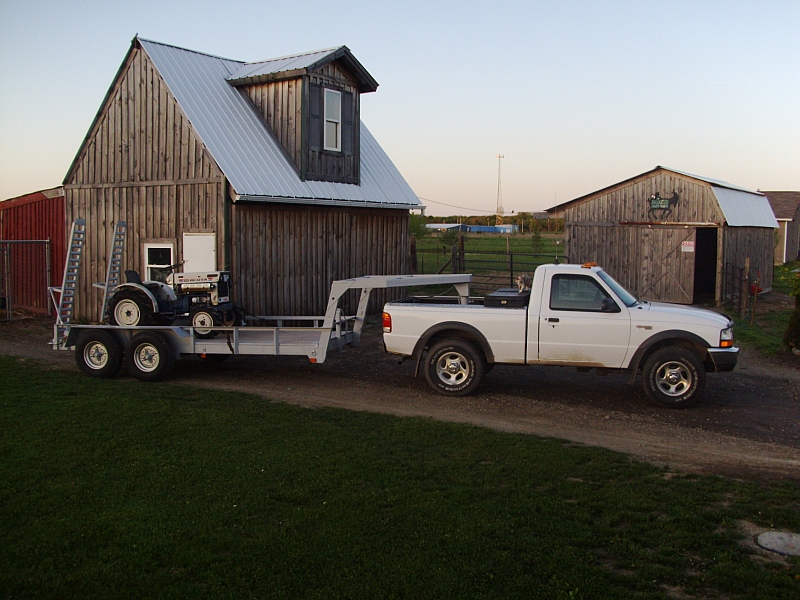

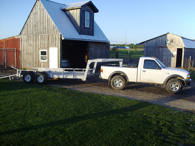

There are actually a few gooseneck Rangers running around here (at least 2), I found the thread where one had pictures, but they've disappeared. I have them saved somewhere.
So basically you're going to be building custom mounts for your truck and ordering a universal (or the ones that are just the basic plate that holds everything) hiding-style system from whichever manufacturer you decide is best for you. So basically any will fit your side-step Ranger, as it'll be totally custom regardless.
Few have tread into this territory, be sure to post lots of pictures. I'll try to find the ones I saved.
Once my employment situation is a little more secure, I'd like to do something similar myself.
Aw sweet! I DO have them on this hard drive! :icon_hornsup::icon_welder::icon_thumby:
Click for 800x600

I'm doing this exact thing. I bought a Curt 61052 and am going to use 2" 1/2" thick steel, as per their installation instructions, to install it on my frame. Then cut a hole in the bed. My '95 Ranger is down to the frame right now and this is one of the things I am doing. I'm building a gooseneck trailer with a single 7,000# axle to haul my ASV RC-30 track loader --plus a few other similarly-sized bits of equipment. Having the ball right over the axle is much, much better than having it way behind the axle. That's an understatement. Having the trailer tongue in the bed of the truck totally eliminates all of the control issues. A semi tractor weighs 15,000# and pulls a 65,000# trailer. A 3,500# Ranger could handle a 15,000# trailer at that ratio. The mechanical beef isn't there, but the control is.

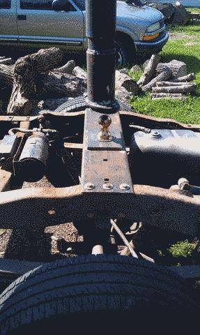

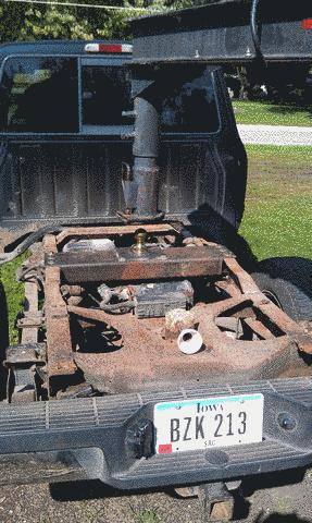

Here's how I did my truck. This is the Curt. The truck is a 6' bed so this hitch barely fits between the tank and the spring hangers. I made the cross pieces out of 1/2" steel and it is bolted in through existing holes in the frame with 9/16" bolts.
