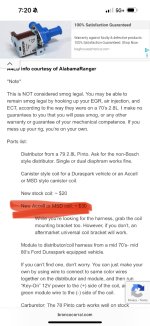

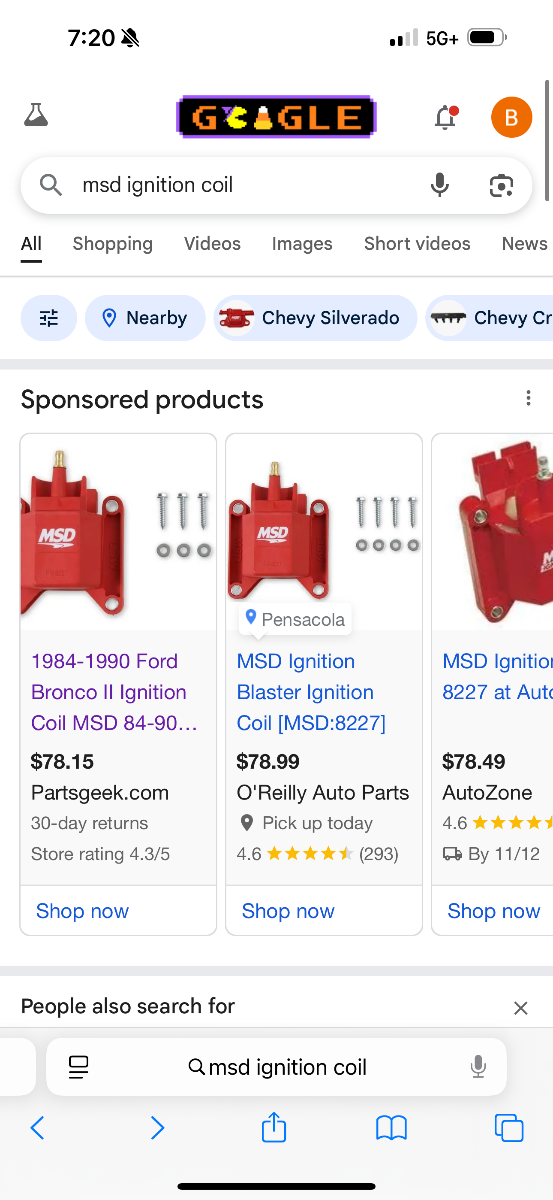

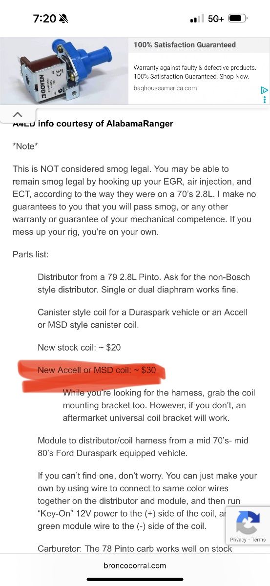

This may be a dumb question, but I’m still learning and trying to conceptualize the wiring for a planned duraspark conversion. Is this ignition coil what I need for the conversion? These are the instructions I’m using and if so, I think it’s the only part I still need to purchase. I already have a new distributor, a canister coil, new plugs and wires, and a duraspark box. However, I didn’t realize until rereading the instructions that I might need this part from MSD as well.

I was under the impression pretty much any coil could be make to work as long as it's wired right. (With a resistor if necessary.)
Are you planning to use a MSD controller?
I wasn’t. I bought a powerspark distributor from England with a canister coil and a regular duraspark box, but the instructions from bronco corral call for both a canister coil and an access or msd coil so I’m just confused.
Canister coil should be fine.
Hell, I've seen them used on ATVs and lawn mowers.
I think you missed the "or"...
One OR the other
The most important thing is coil resistance- too low and the spark will be slightly hotter but the module will die early and often.
I thought the Powerspark distributor comes with an electronic ignition built into it. I wouldn't think you would need the Duraspark box.
With the TFI I coil like those pictured I could get about half an hour of idle time out of a DS module...
DS cannister coil and as long as it stays dry the ignition has been bulletproof.
Jim is right... that distributor doesn't use a duraspark module. It has the electronics built into the distributor. I would bet it similar to a Petronix. At least that's what I found when looking up powerspark distributor on ebay.
