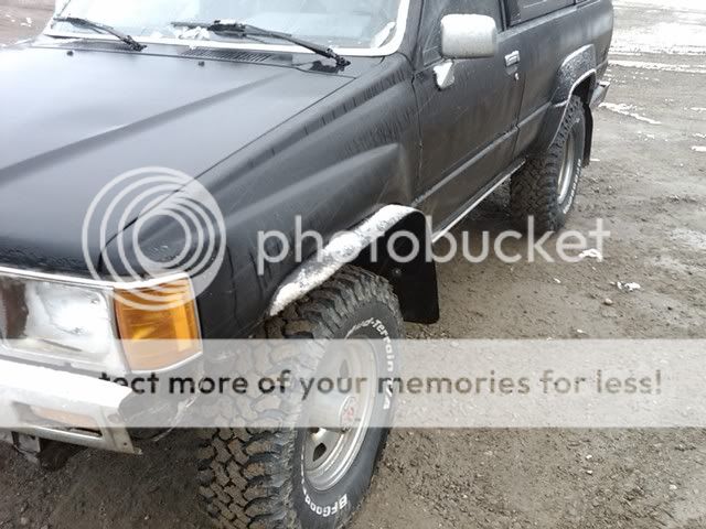

It's in the works... I don't want to get an MVI on this one like I did on my Ranger. I'm going to either make some out of some 18ga checkerplate aluminum, or use old conveyor belt. So far I'm leaning towards conveyor so that WHEN I rub it against a tree, it just folds over and goes back in place, rather than bending. :icon_bounceblue:

how much of a gap do you have in the back wheel wells now that you cut the fenders?
No gap, I welded in new sheetmetal after bashing the inner well with a BFH. But there would have been about a 3" gap in the rear well if I wouldn't have welded it up.

I can get one from the underside... I've got my interior plastic on now and it was a real PITA to get it on after... I don't want to take the plastic off again just to get a picture... haha! But it's really not hard, if you tackled a half door, this is basically the same. Cut, bash, template a patch, weld. Easy! Just make sure to seam seal it after.
