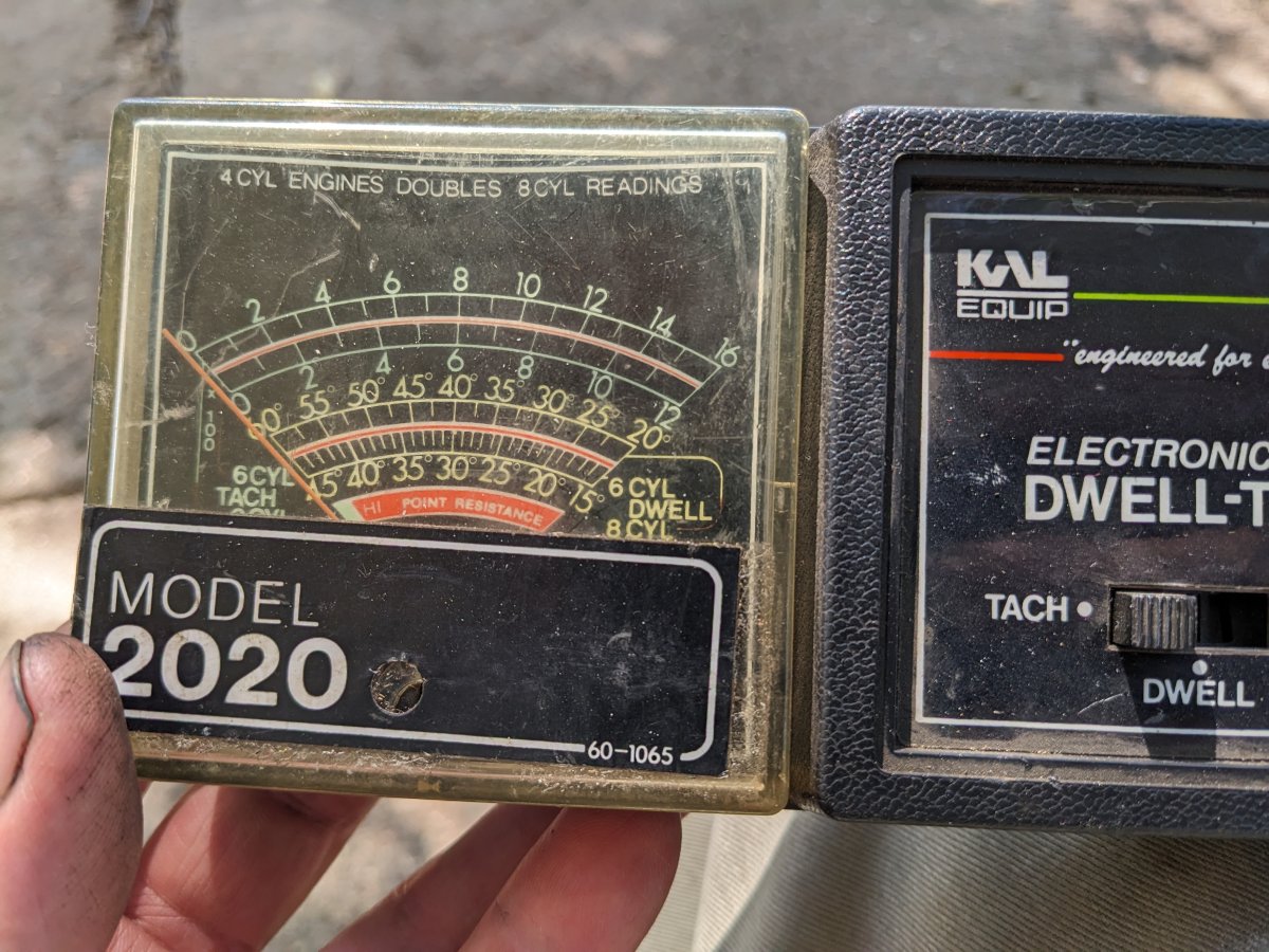

The 2.3l truck doesn't have a tach. I have two things available to try to figure out engine speed. One is a multi meter that has a Hz reading. The other is this old analog tach. I stick wires into one side of a coil pack. I get a reading of a bit under 3000rpm on the 8 cylinder scale. Using the multi meter I get a reading of around 9.3Hz which multiply by 60 comes to 558 cycles a minute.
Now with the tach, I'm thinking that one side of the coil pack would fire every revolution. A single coil on an 8 cylinder would fire 4 times a revolution, right? So I would assume that the scale on the tach would read the same for a 4 cylinder with coil packs. But it doesn't feel like it's idling at a bit under 3000rpm.
I'm confused.
