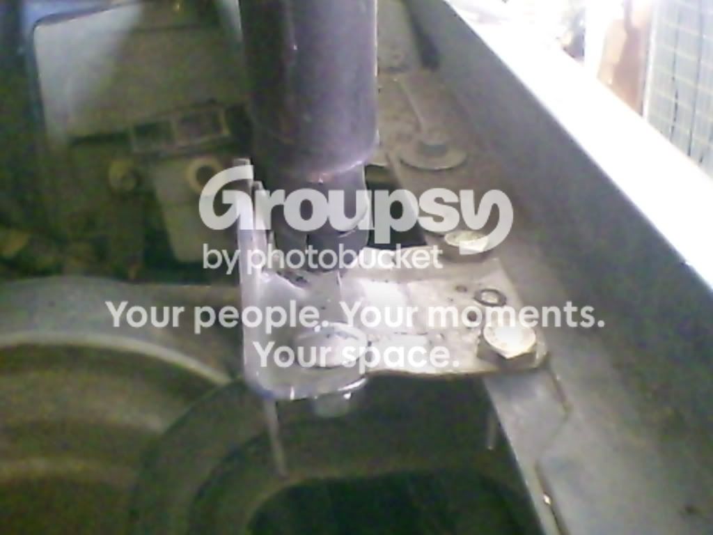

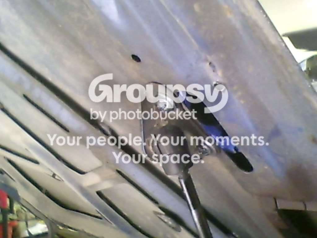

I replaced my old hatch with one that has the flip up glass, so I took the strut mounts off of the old hatch. Put one mount on the underside of the hood and made an 'L" bracket for the other end to mount off the inner fender.
Had to notch the underside of the hood support to get it to clear. I just used one of my old struts that was too weak to hold up the hatch. I could have made it look better, and will on the new hood.

First pic, bottom bracket, drivers side.

Second pic, top bracket, drivers side.
