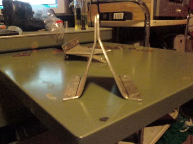

here you can see the shape of my mounting brackets.
strvger, I did exactly that to mine, but made them removeable. Handiest things in the world! One full of tools that I'm always using, one full of gloves, tiedowns, ductape, etc. made mine removeable, (held in with a cotter pin so I can bring the toolbox with me!) I've got a .50 cal for when I convert to bucket seats so I'm really looking foward to seeing how you do yours TE! I've even got yet another one or two that I plan to mount in the bed so I can keep bigger misc. crap in it and outta the passsenger seat but I'll bolt it in and weld on a tab so I can lock em. I found a deal and got 7 boxes in 3 sizes for like $20 so I'm kinda ammo box crazy lol
