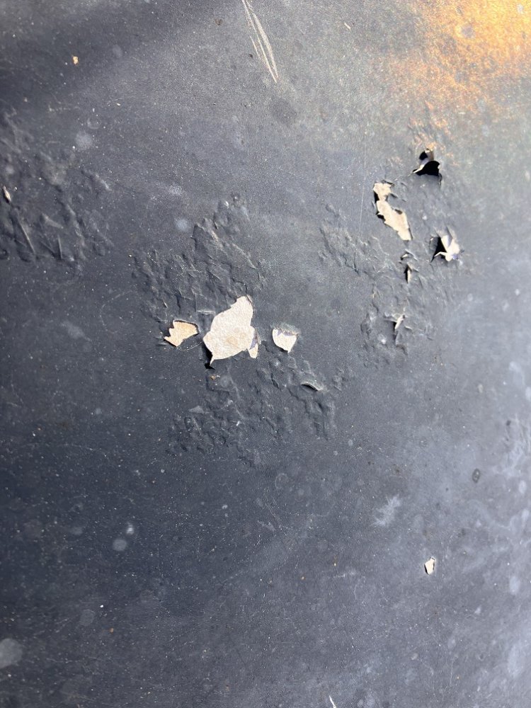

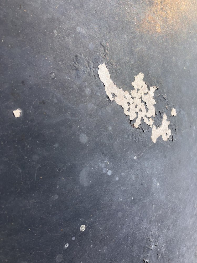

Da OOGLY truth:
Orange "stuff" is sunrise-glare, not rust... (rust is on the steel parts, durn...)

ouch, that will probably grow exponentially once you get started.
Yeah, definitely do something now. Aluminum can corrode just as badly as steel, and you can end up with holes quickly.

I'm afraid that hood is past the simple spot repair stage. It's probably best to send it to a shop with Al experience for a complete strip/fill/and prime. Getting a good final paint finish is really dependent on a shop using the correct etching primer for Al. People that think aluminum doesn't corrode have never had an aluminum boat on the Oregon coast; it's a constant battle to keep it in check.
in the rust belt salt does a major number on aluminum. the tiniest rock chip allows corrosion to creep away under the finish coat unnoticed.
