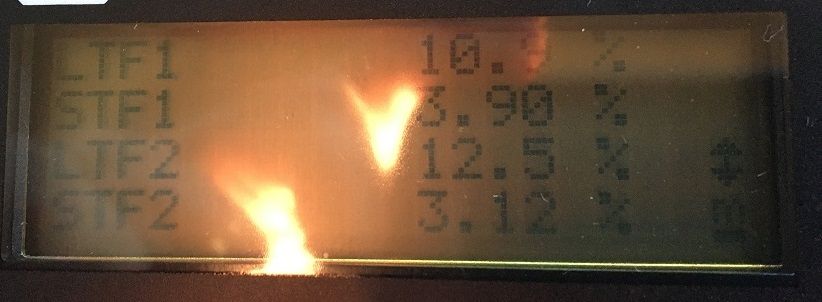

If you can see Live Data then look at STFT on both banks, you will probably find both banks are in the High "+" STFT(above +10) and close to the Lean code line for computer to report the issue to driver, i.e. lean code
I've got Live Data on my reader... what's the normal range for STFTs?... at idle?... at 2,000RPM?
0%
Slight switching up and down maybe +2% to -2% if you watch it over a graph is normal but balance at 0%
STFT is instant and should maintain 0% unless the long term fuel trim adjustment has been maxed out either high or low. Any major deviation in STFT means LTFT is no longer capable of correcting because a major deviation in short term becomes long term up to a certain percentage.
You calculate your total fuel trim by adding what the long term number is with the short term. Long term at +20% maxed out and a short term at +15% maxed out is a 35% positive fuel trim (check engine light is furious). But long term can be +15% or so and as long as your short term is 0% you're fine.
Long term is learned data depending on where you live, altitude, engine condition etc so the truck runs it's fuel maps based on that learned data. Short term is only for minor instant correction.

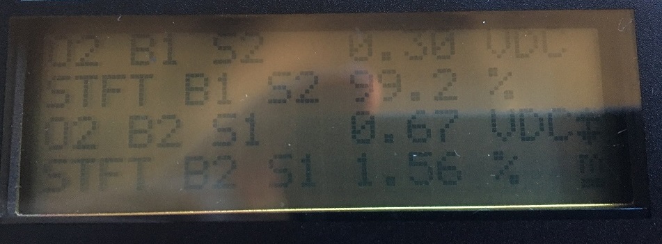

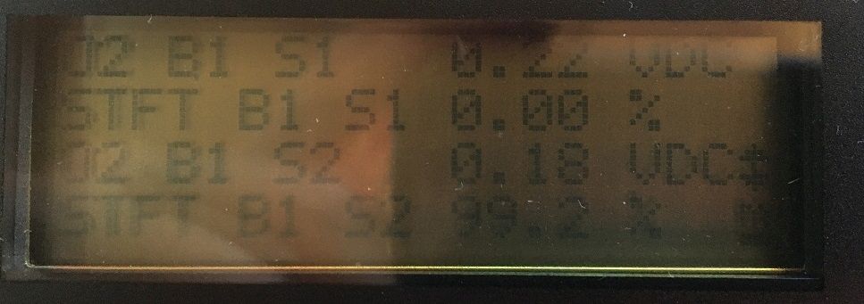

OK, streamed some beaucoup data... needz me some guidance distinguishing between the various STFT readouts:
64066
64067
64068
SOOOooo... STFT B1 S2 seems to be way out there at 99.2%...??
Values of 99.2% for STFT can always safely be ignored. Per SAE J1979, "99.22%" is exactly what a PID is supposed to report "if this sensor is not used in the calculation". Since this is a downstream sensor ("S2"), it has no effect on the fuel calculations, it's just used to monitor the catalytic converter.

B1 = Bank 1, passenger side of a "V" engine or only Bank on a 4cyl
B2 = Bank 2, drivers side
S1 = Upstream O2 sensor, sensor closest to engine
S2 = Downstream O2 sensor, sensor after Cat converter
Full Dual exhaust "V" engines will have TWO S2 sensors, B1S2 and B2S2
Normal single exhaust "V" engines or 4cyl, with just have one, B1S2
But your voltage on B1S2 is low, 0.30, S2 sensors should be at 0.70 to 0.80 VDC, time to change that sensor or get New Cats

As I said, SAE J1979. ;) That's one of several SAE documents covering OBD2 "stuff". Most of it is not what you'd call "light reading", so I serve as an interpreter sometimes in cases like this. "+99.2%" is the maximum value that can be represented for STFT. It's sort of a "flag" to say "ignore me". :)
As for the O2 sensor voltages, frankly, looking at a single value can be misleading, especially for "upstream" sensors. You really want to see a visual timeline of data (e.g. a graph). And you should also be cognizant of things like engine run time and open-/closed-loop status. But even for "downstream" O2 sensors ("S2" in this case), I've seen them report unexpected values under various conditions. Seeing a 30- or 60-second graph is typically far more useful.
