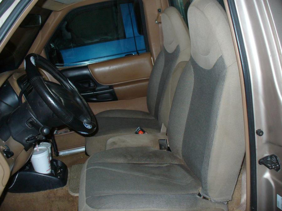

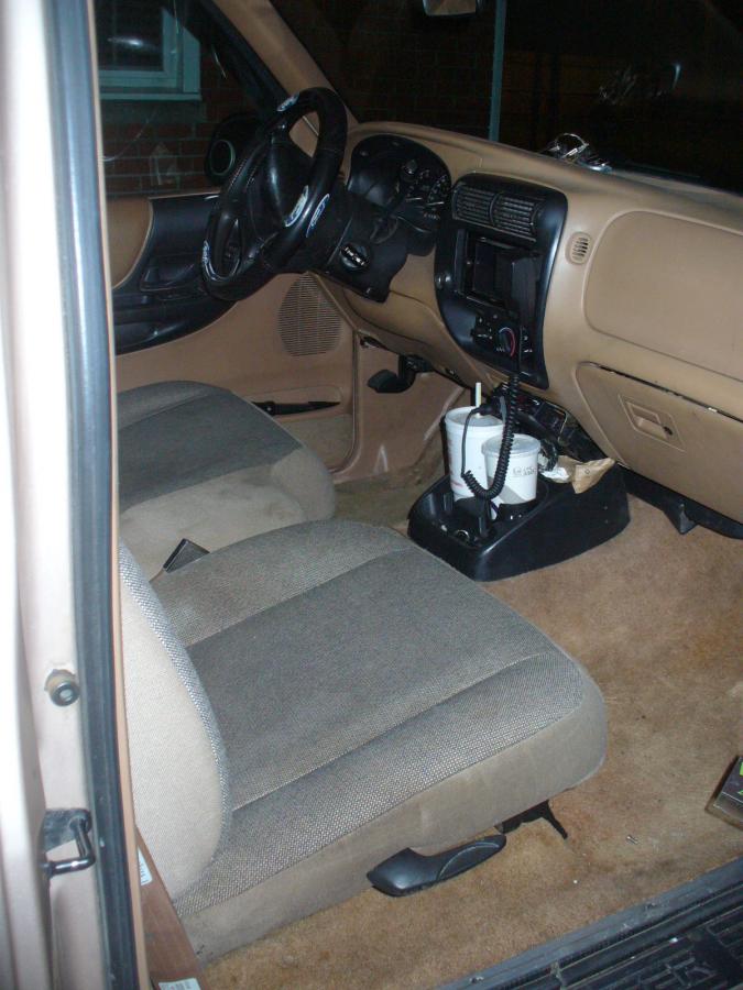

Finally found some seats... I grabbed some (and the matching floormats, which are currently drying in the garage) from a 2000 Ranger at the local Pull-A-Part.

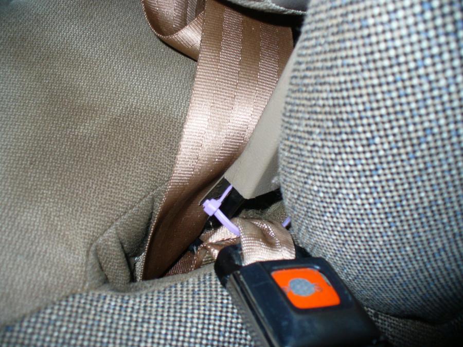

I did have to unbolt the driver/passenger seat buckles from the buckets, and I did have to cut off the plastic sleeve on the existing driver's buckle to allow it and the center belt to route through the new seat's hole. I used a zip tie to retain said buckle by routing the zip tie through the neighboring armrest support.
Seats installed:

Zip tie fix:
attachment.php
The only other issue I ran into is the newer seats were designed for bigger seat bolts; while they mostly lined up OK, the stock bolts for the old seats don't provide a lot of metal to metal contact. I'll be buying some fresh bolts and fender washers to fix this (as I don't see drilling and tapping the floor threads for the larger size going well).
These seats ride about an inch or two higher and have more slide/tilt adjustability. Which is good for my wife, who was having to use a pillow and a backpack previously to drive my truck, now she just has to slide the seat forward.
Also, the armrest lid (like every other ranger with this design) is busted... but all the pieces are there, so I can probably find a way to fix it (I'm thinking sheet metal with the latch striker somehow attached).
