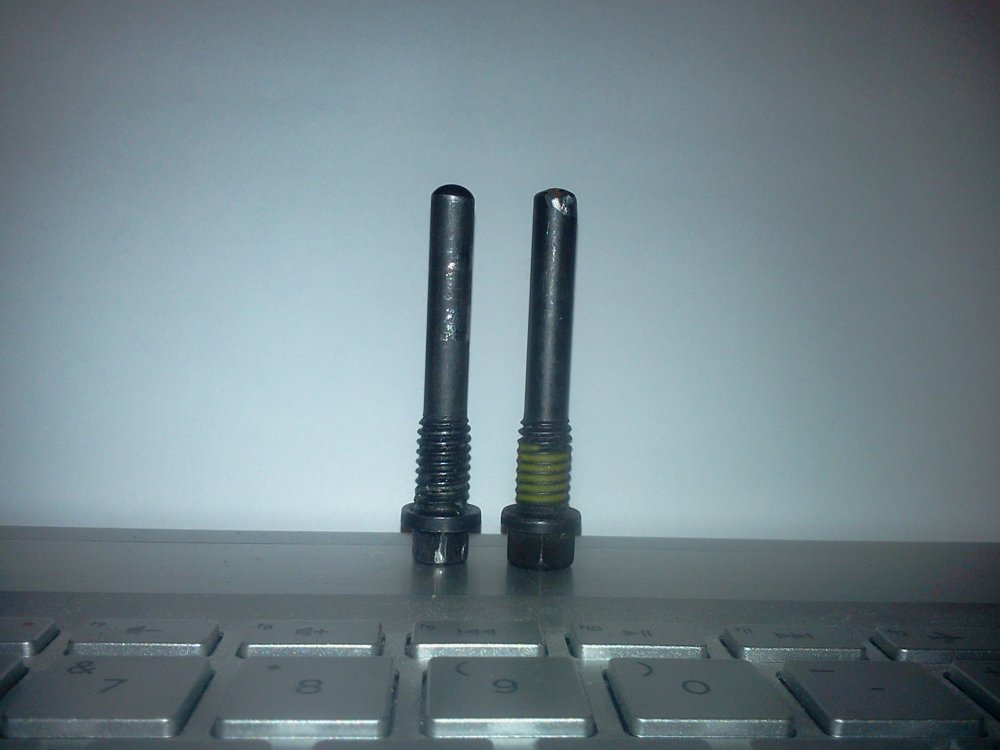

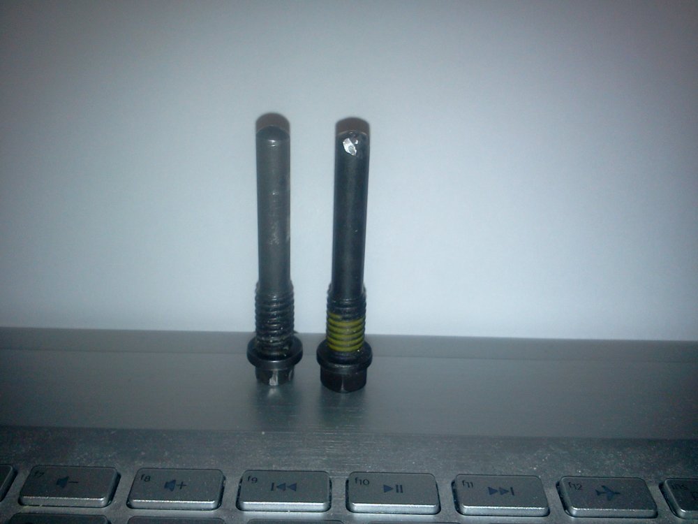

the pins for a Ford 9.75 / 10.5 will work if shortened about 1/4"
same pin diameter, same threads
bonus!!!! the head is 3/8" hex instead of 5/16" for those that like to strip the head.
