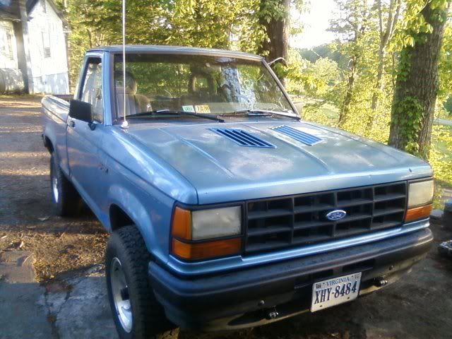

Started reading this forum a few months ago and got info to put 87 T-Bird turbo engine with T-3 into my 91 4x4. Still have paint & body to do but it's on the road after months of reading and skinned knuckles gotten in my spare time. T-Bird oil pan touches cross member, hopefully aluminum Ranger pan will fit.
Using front mount IC from Volvo, E6 manifold, Diamond forged pistons, Ranger roller cam.
