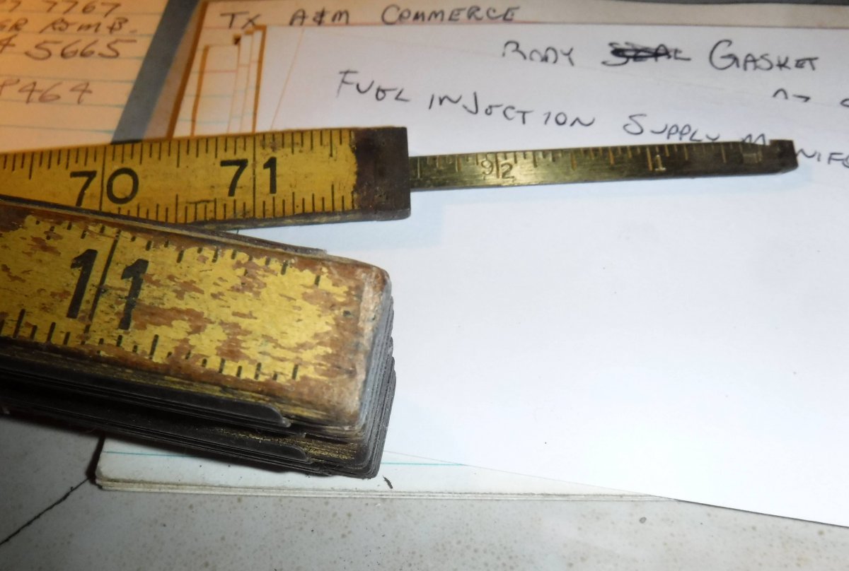

I would however use a carpenters rule (with the end slider for making accurate inside measurements), in measuring for simple toe in, but as was already stated, there is often too much in the way to get a good measurement front and rear.

I have a folding ruler with the slider. I will use it to check my toe in/out. Since I adjusted it the steering is better. It was wondering and I had to constantly work the steering wheel. It's better now. I want to look at those bushings. As old as this truck is, they must be worn pretty well out. Thanks for all your help.
