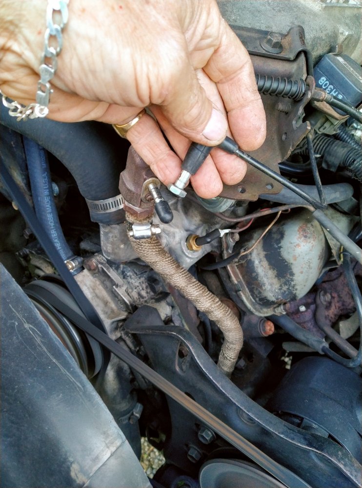

Did the test one at a time, pcv did nothing and the "EGR" test the small needle deflection stopped and was steady at 21. There are two vacuum hoses going to the EGR valve.
For which one?
