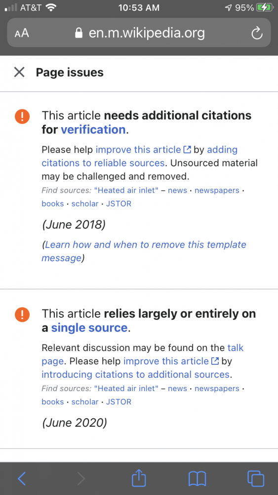

Don’t ask me for for the answer, but Wikipedia says: “…for the purpose of increasing the consistency of mixing of the air and fuel in order to reduce engine emissionsand fuel usage.”
You know wikipedia can be edited by anyone, right? Cars had hot air snorkels primarily for improved running and faster warm up in cold weather, a warm engine is more efficient and therefore would run cleaner but that was a welcome side effect, not the main purpose. The cold air would cause the gas to liquify instead of staying vaporized. I only drive my Mustang and Ranger in the warm months( mid April to very early November in NH) and neither has a preheater tube, you definitely don't need one in Florida.

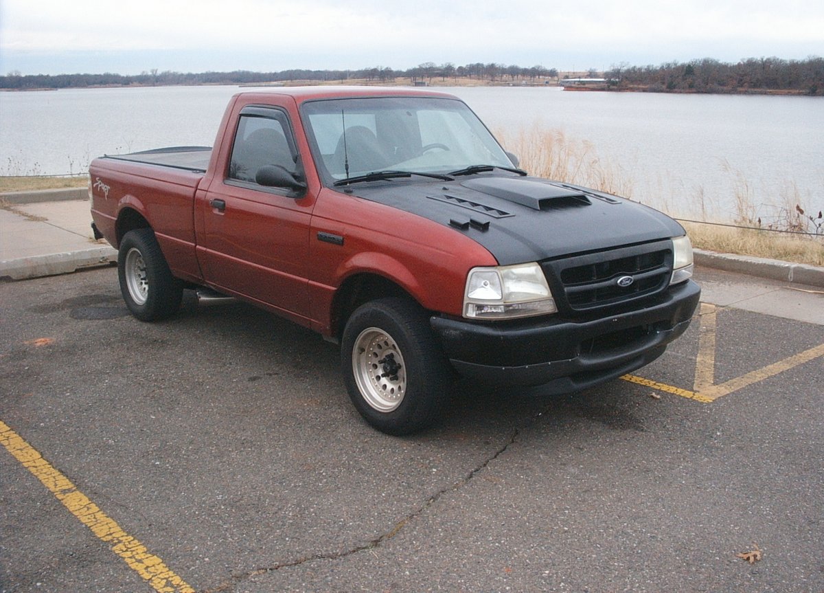

Any vehicle I ever had that had one of those hot air tubes, I removed it first thing. Never had an issue, even in the winter. I don't want no hot air in my intake. While all three of my current vehicles do have aftermarket cai's on them, they all also have methods of routing cold air to the filter. Lightning and Mustang have tubes running from the front to the area where the filter resides. Ranger has two small scoops on the hood directly over the filter, and also a three inch tube from inside the lower "grill" opening. Man is it a good running 3.0. I get asked frequently what size V-8 it has.
Probably mostly good info. But take it with a grain of salt. Wikipedia articles are written by people like us. This particular one contains this disclaimer.

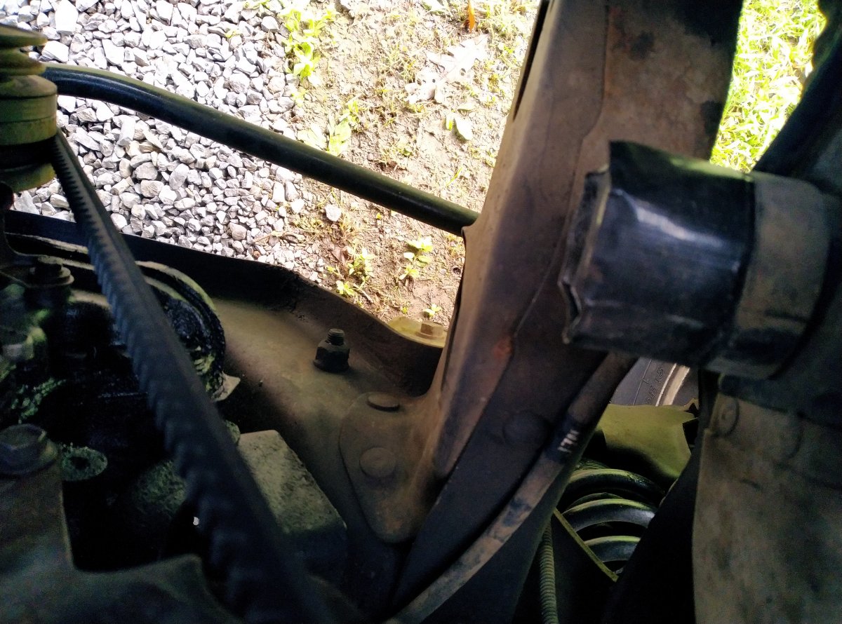

Here is my CAI valve door. Its been taped off for years. Don't know where it is suppose to be ducted to.

Should i water proof it or run it higher?
Should be a 2 part, thin metal, "shield", bolted to front end of closest exhaust manifold, it would have the same size round tube connection as in you picture
Parts 11 and 12 in this diagram: https://dz310nzuyimx0.cloudfront.ne...aa4f7a84/f0853f92af9e96d475ae554de29ce759.png
Center of 5 is whats in your picture
10 would the flexible tube that connects center 5 to 11/12

Thanks RonD. my part 2 has been gone a long time. Got the valve covered up. It still works. I uncovered it and watched it close slowly as the temp rose. My ranger dont like start ups , it stumbles until you feather the gas a little. Thought warmer air on start up might be easier on it.?
Yes, remove that tape over the valve inlet, just prevents air flow when it opens
Hard start could be just lack of air flow until valve closes and you get full flow from CAI
