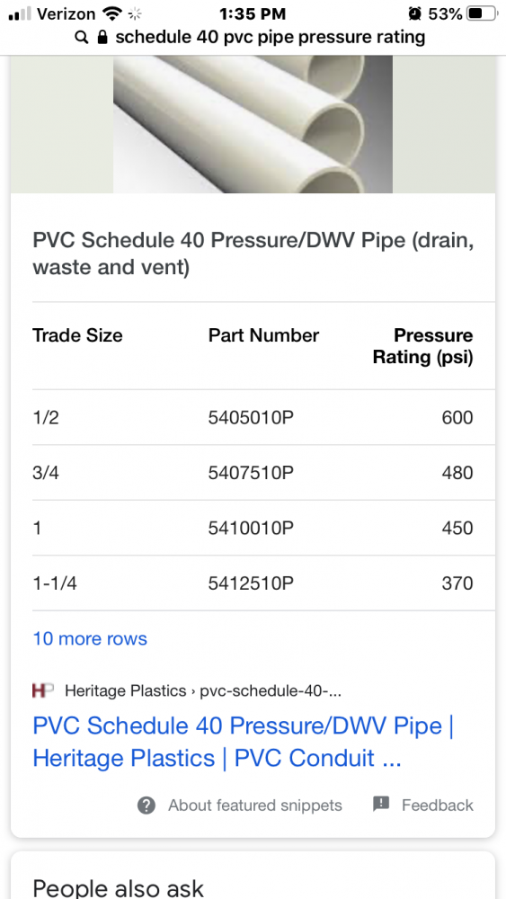

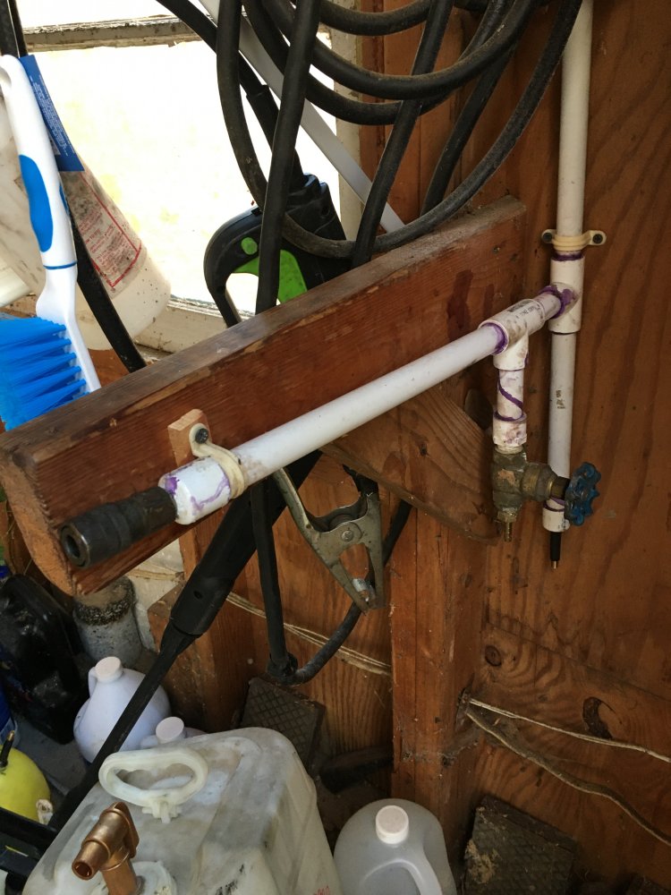

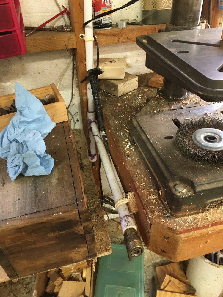

“Real” air pipe is expensive no matter what you get. But a lot of that is for “pretty“ or for “risk management“ on paper. Glued schedule 40 PVC up to about 1 1/4” is completely safe for virtually anything any of us would do at home.
The most important things are to prime it properly (coverage and soak-in time) glue it properly (rotate each fitting about five or six times till there is no tendency to push back out) and let it sit longer than usual. I learned this from my body shop guy, and I’ve been doing it for 30 years without one ever breaking or popping. Most of mine is 1” feeders with 3/4” drops, a couple 1/2” runs to low-volume stuff like blowing shavings off my drill press. Most of my installations are fast and dirty, but safe, but you can still make it as pretty as you want by buying a few more fittings and being a little more careful with the primer and glue. If I’m running over 15 feet, I’ll usually put in a 12” “U” - like a steam line shock/expansion loop - but I loop it to the side or I loop it overhead depending on where I want condensate to go. And I think I just mentioned I use a lot of tire/Schrader valves to drain moisture. All works like a charm. Also a lot of cheap brass cut off valves on various parts of the system.
Two disclaimers: I don’t think I’ve ever run over 90psi, and you guys in the frozen north should probably double check temperatures when you’re putting it all together, and you may want to put in an auto-freeze drain or two.
View attachment 53261View attachment 53262
my 2 cents, hope it helps!
