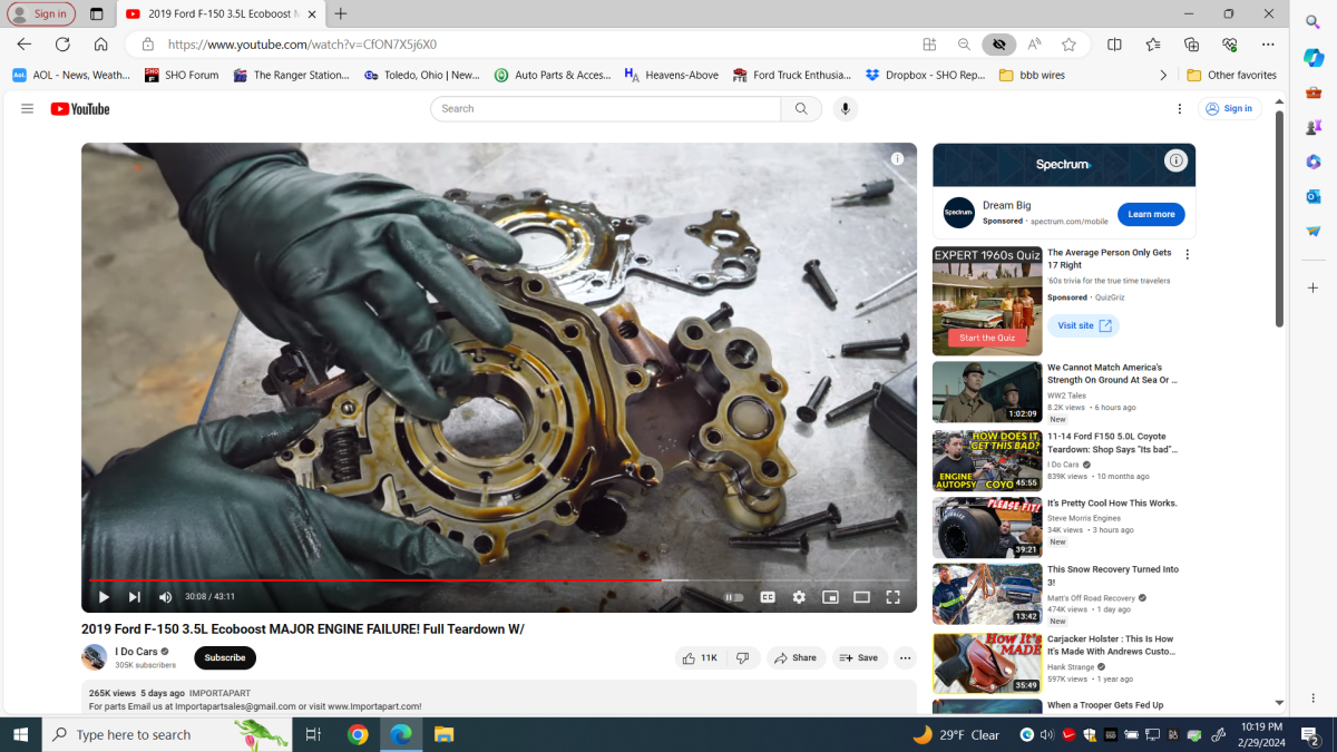

from a video, "I do Cars" where a tech dismantles bad engines.
this is the oil pump from a 3.5 Ecoboost. I didn't know they used the vane style.
EDIT: oops, I should have started a new thread. sorry.
