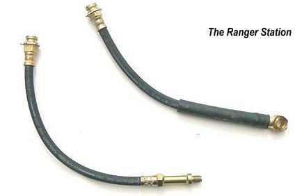

I finished up the brakes on the rear axle tonight. The rubber hose on the axle wasn't long enough so I put one of these extention lines on it from autozone.
I also run new hard lines and had to buy new Caliper bolts as i had Rock rashed the old ones. Tomorrow night I'm building skid plates for the T case and gas tank. RB
