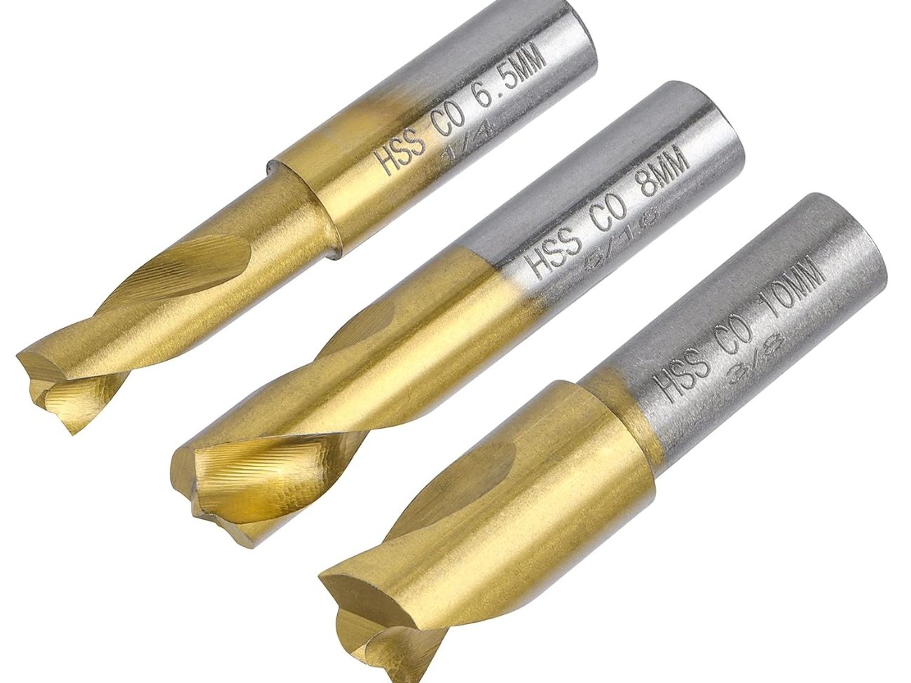

Yes it is. There are two areas that you can potentially drill out spot welds to remove the front clip. At the firewall, or at the core support to inner fenders. I would probably do the core support one using a spot weld cutter drill bit of the correct diameter. Do not drill thru, just remove enough to seperate the 2 pieces.

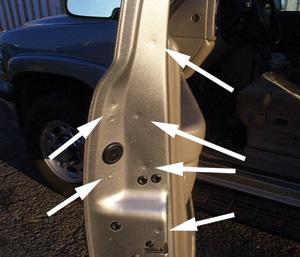

The core support is not soldered in. It is spot welded. Welding is a process that melts 2 pieces of the same metal to make them become one piece. Soldering involves melting a different softer metal (solder) and using it more like glue without melting the pieces being joined. If you look at the core support where it meets the inner fender pieces, you will see round spots where the 2 pieces were melted together. What you are trying to do with the special drills he showed, is to drill far enough into the “spot” to free the 2 pieces from each other. If you don’t drill through, it is easy to weld the pieces back together during re-assembly. Photo below has arrows pointing to spot welds.

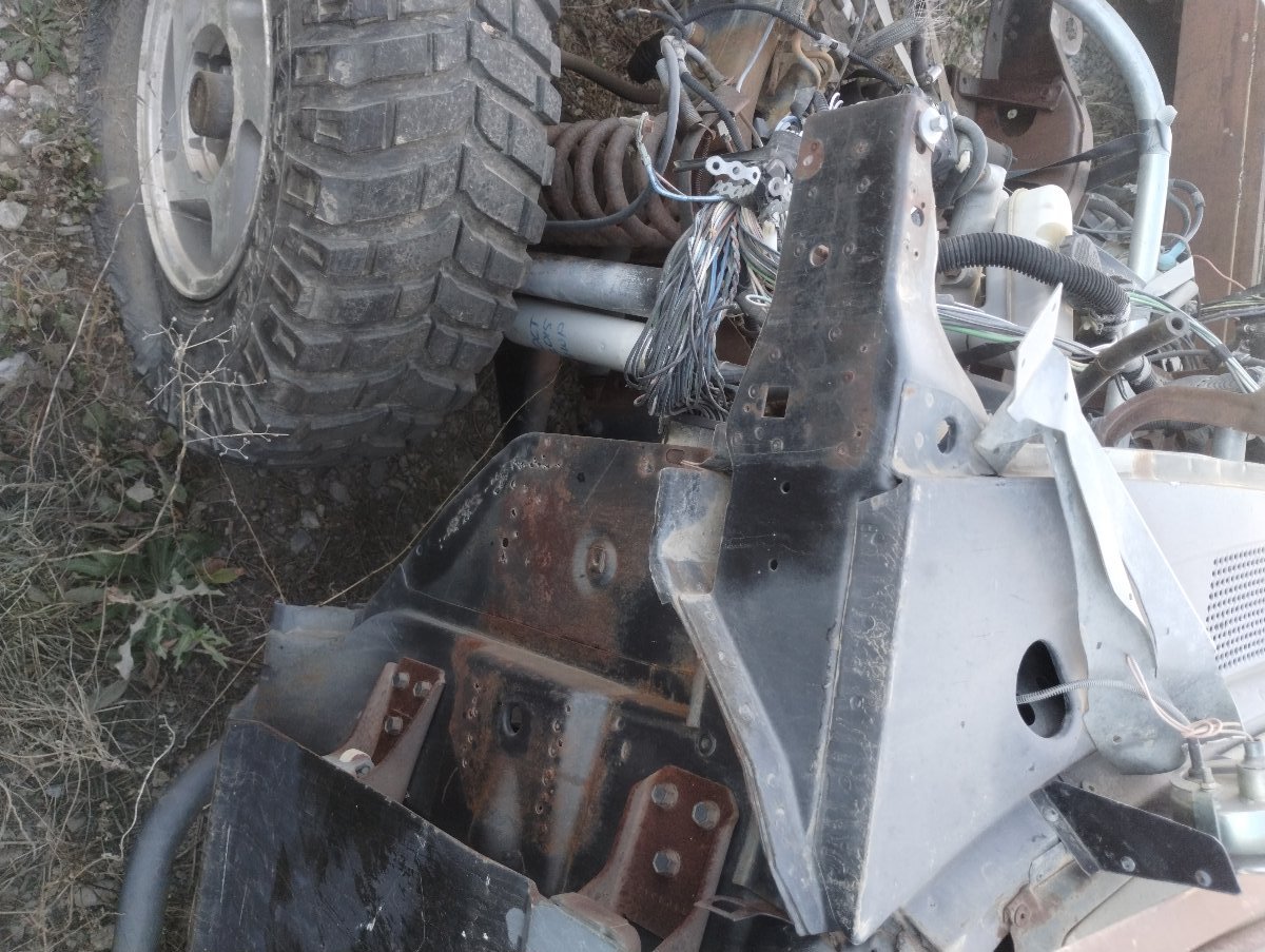

i prefer to make the core support removable as a unit with the inner fenders intact, if there was an engine upgrade possible in the future then i would definitely invest the time into making the core support removable. this is required when i do a v8 or non ranger based vehicle engine swap.
i remove it at the cab horns. it is the fastest and least amount of work and drilling and cutting.
with a stock truck it is an absolute pia the first time but definitely worth the effort.

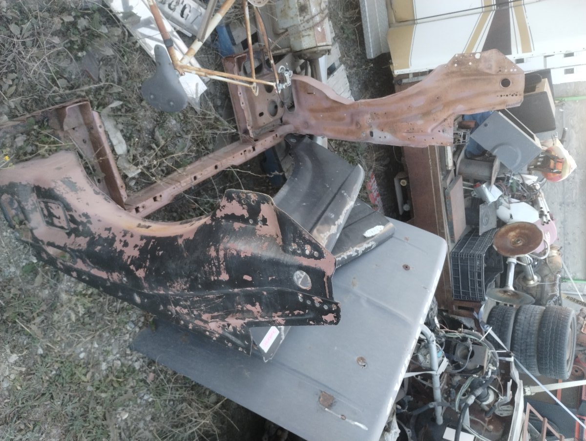

Pics of core support and inner fenders as one unit. Already removed...
IIRC, front bumper, grill, fenders, and doors need to come off to get at the spot welds. I think 27 on each side. To do the core support alone its the same except no doors come off. I dont remember how many spot welds for that.

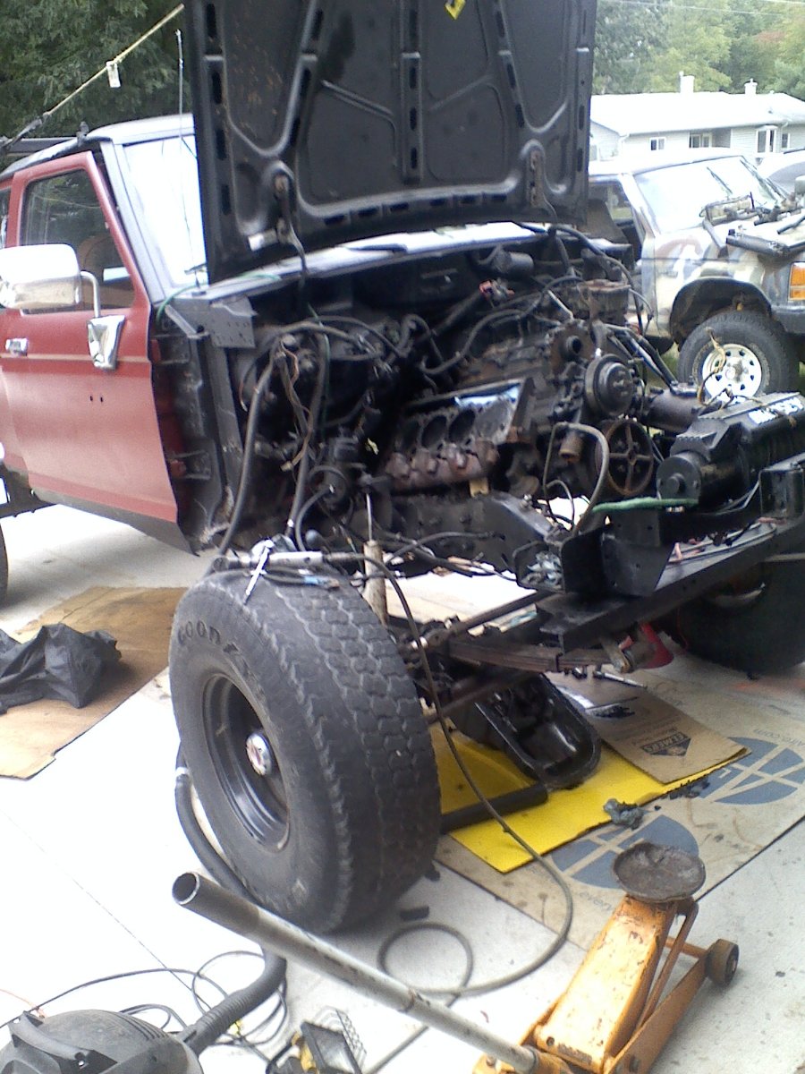

I have used many things to accomplish that. 25-ton crane last time. Two trees with a chain 15-20ft up and a chain hoist hanging from that. A wooden frame of 2 posts with a wooden cross beam and a come along. Both of those we lifted the engine then had to push the engineless truck out from under the hoist. Then swap engines, and push the truck back under it.
I’ve pulled motors using engine hoists, chainfall from a beam, skid steer loader, backhoe…
