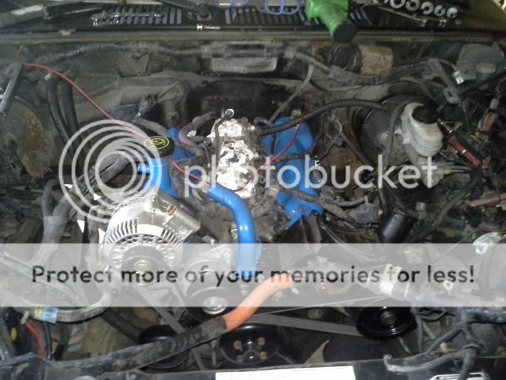

Alrighty. Engine, trans, and what not is all together (still haven't heard back from Headman, but I'm not surprised in light of the holiday). I did get my hands on an 89 dash harness to compare to the 88 for comparison so I started in on the wiring.
Engine harness in:

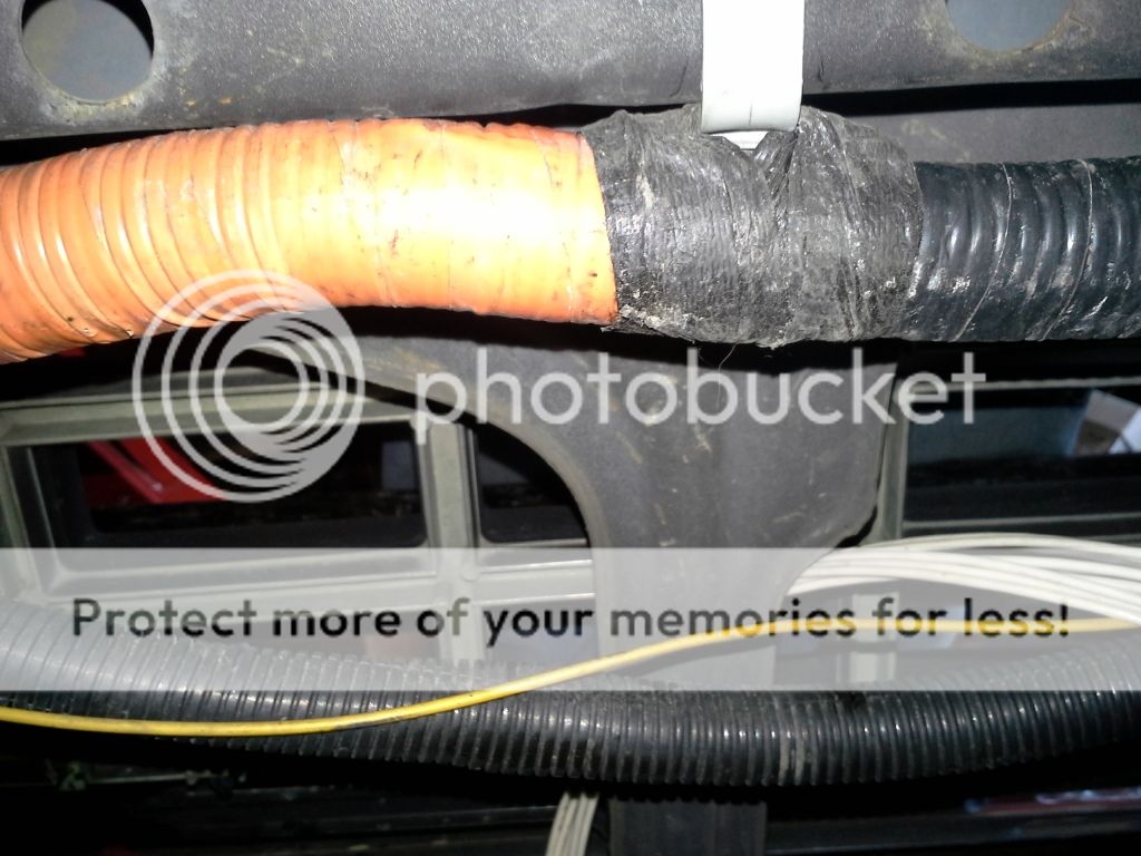

Cross harness:
adsm08's Ranger build up
Almost looks like it belongs there.
