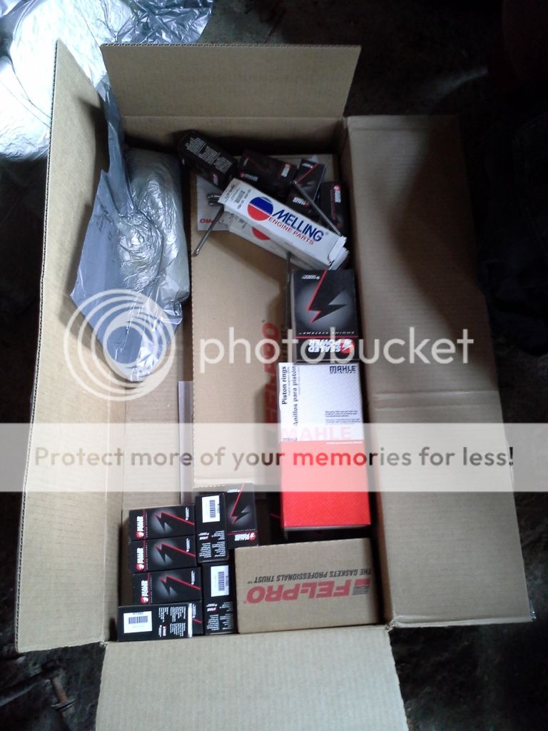

Well, here is 6 months of saving, scrimping, side work, and scrapping turned into car parts.
adsm08's Ranger build up
Soft-rebuild kit and headers for the 4.0.

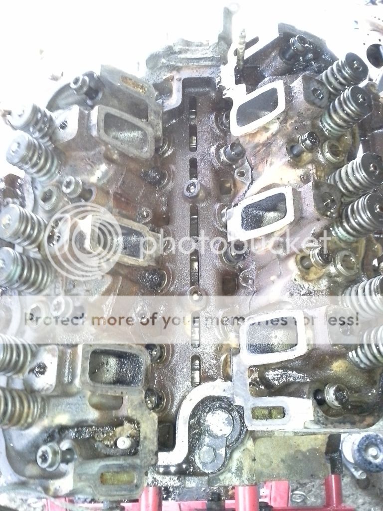

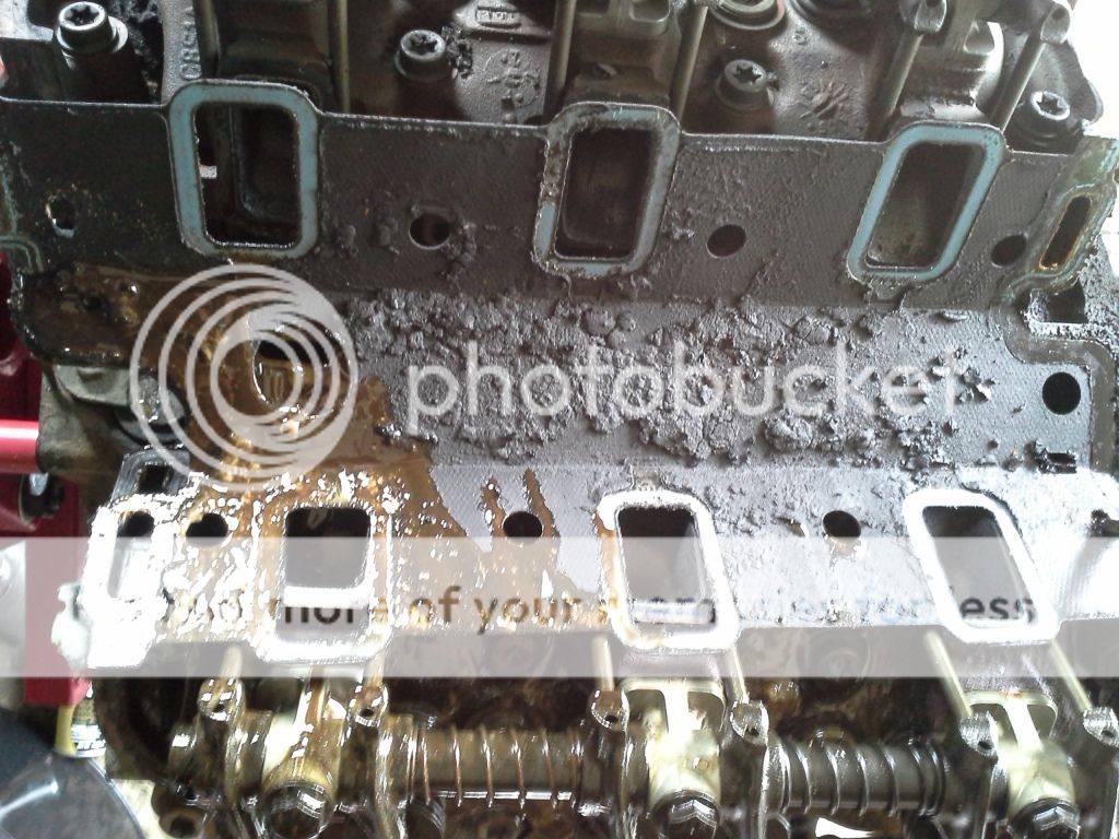

Hmm, this doesn't look good. There is water in that oil.
But the valves look OK.

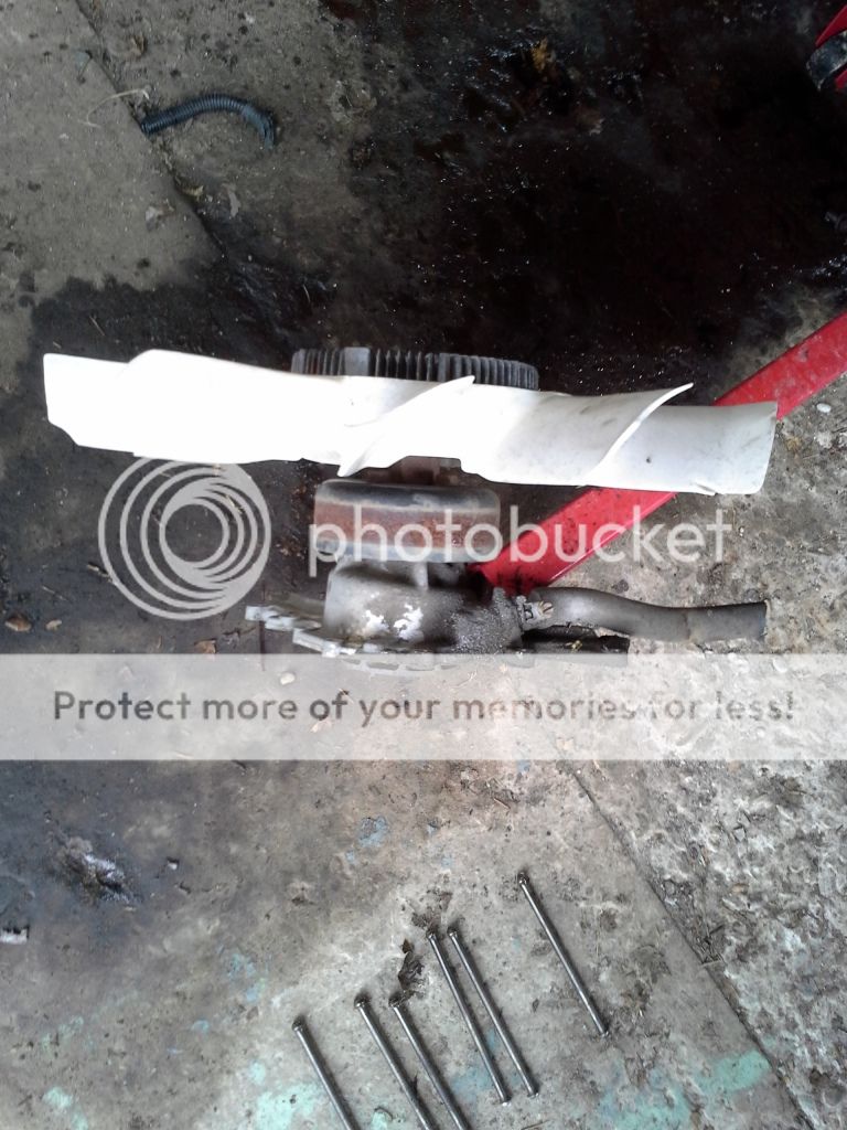

Anyway, the fan is shot.
Also, I am not really sure how I am going to get it off the pump.
Anyone ever take the water pump off with the fan still on?
Turns out it isn't so hard if the engine isn't in a vehicle.

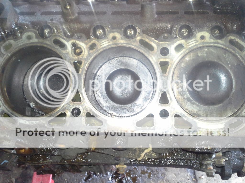

Heads off. Shame I was taking it apart so far. Those head gaskets were still good. Took a pry bar to break the seal.
Block cleaned up real nice.
But this thing def had at leas an inch of water in it.
It doesn't appear that anything was damaged though. I need to flush out the oil pump and I need more brake cleaner to clean the block out, but aside from the yuck and a rounded, possibly frozen, drain plug the worst thing I've seen is a little surface rust on the one crank weight. The cylinders are OK.
yes, lol. had to do it on my 2.9. i was replacing the water pump and couldnt get the damn fan off while it was still in the truck. i clamped the water pump in my vise and popped the fan right off. damn, what a PITA
I am thinking strap wrench and pneumatic fan clutch set. The pump and pulley are fine, it's just the fan blade that is shot, but I am putting a clutch in it too just because it looks awful.
i had tried a strap wrench on it when it was still in the truck, but it just would not budge. once i got it on the vise, i used an adjustable wrench and my BFH and it came right off with a few hits. (this was in my early RBV days before i was informed that a little heat could help loosen things up lol.)
I used a vice to get one off of a Chevy 4.3's waterpump. Probably the easiest way to do it if it's not on the truck.
I actually used the hand wrenches we have at work for fan clutches. It was barely even tight. Almost like someone spun it on snug and hit the key to let it tighten itself up.
