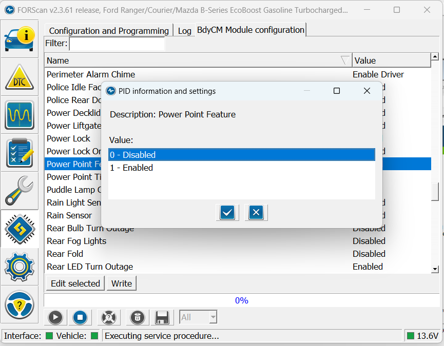

Go into BdyCM Module Configuration and look for Power Point Feature:
The Power Point will show enabled. This actually determines if the Power Point Timeout (the setting below it) is enabled or not.
You can make the power points stay on by changing this setting to Disabled.
Then save the change. This will leave the power points turned on all of the time.
I set this at 9:30 PM and went back outside at 1:00 AM and the power was still working 3-1/2 hours later. So, I can confirm that this will keep the power on.

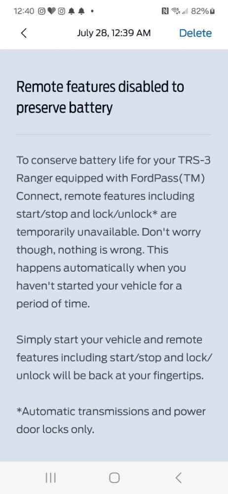

However, at 12:39 AM I had received an alert on my phone that the remote features in FordPass had been disabled to preserve battery power. I had never received that alert before. I don't want to lose that feature if I can avoid it. Coincidence? IDK. Maybe.

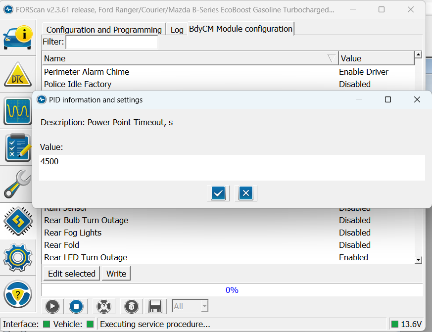

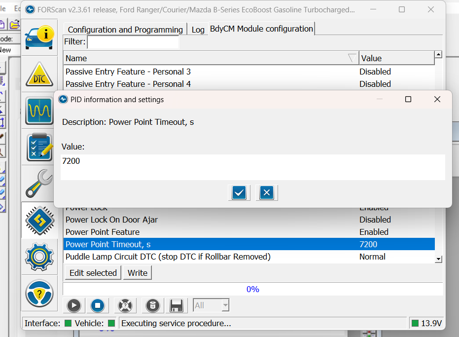

I decided to go back in and change the time out settings to enable to power to stay on for 2 hours instead of 1 hour and 15 minutes. 2-hours equates to 7,200 seconds. If I decide to add a fridge or need constant power back there, I know how to go back and change it later.
Going back into the BdyCM Module I clicked on the Power Point Timeout,s and changed the factory setting of 4500 to 7200 and saved the change.
Now the power points should stay on for 2-hours.
