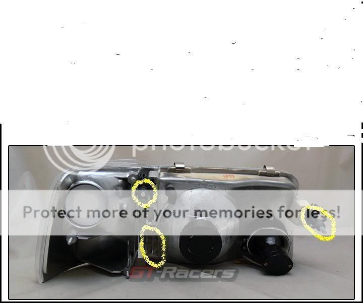

heres a pic of what should be adjusted with the tool. the lower left one is where you will need to insert your existing adjuster from your stock or aftermarket light to your new one
(i circled what ones you can only adjust)
Yep, those are them.
