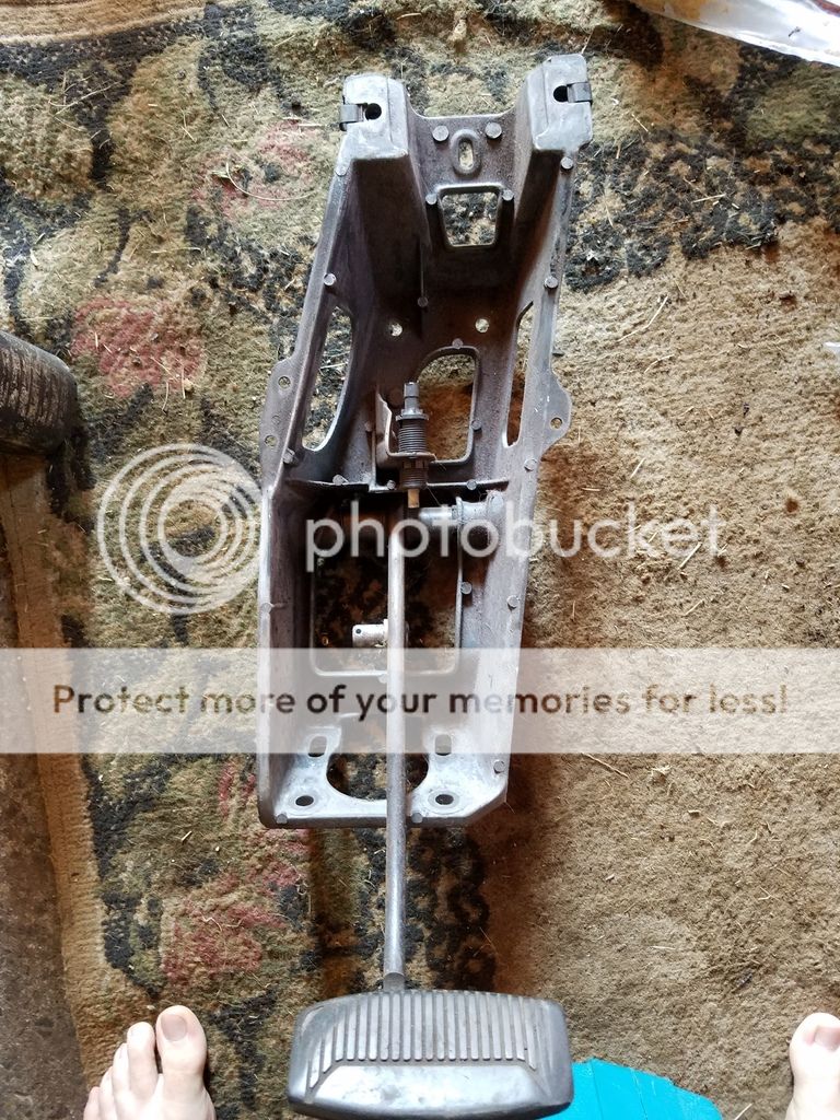

It was a 5 speed, I robbed the vacuum dump valve from the brake pedal assembly. I got home and I was going to go ahead and put the little valve in mine (which is an automatic) before I lost it... and I have nowhere to put it. Anyone know if there is a extra bracket to hold that?
Here is the pedal assy from an 87 with auto and cruise. The dump valve sits in it's own little bracket that is held by two 10mm nuts on the top side.
FWIW this is a spare part from my current build, as the body donor was auto and the final product won't have cruise. I am very willing to part with any or all of it if you catch my drift.
A picture truely is worth a thousand words, thanks. :icon_thumby:
Hang on it to it for a bit, the thing is if I find one in a JY for no bigger than it is I doubt they will charge anything for it...
And I have a manual pedal assembly in the barn, I wonder if it has one too (probably different if it does)
And it had it, I thought it was out of an older BII and probably didn't have cruise, it must have (I didn't pull it, guy threw it in with my D35 to get rid of it) Of course the petrified white plastic bumper broke off when I tried to remove it.
