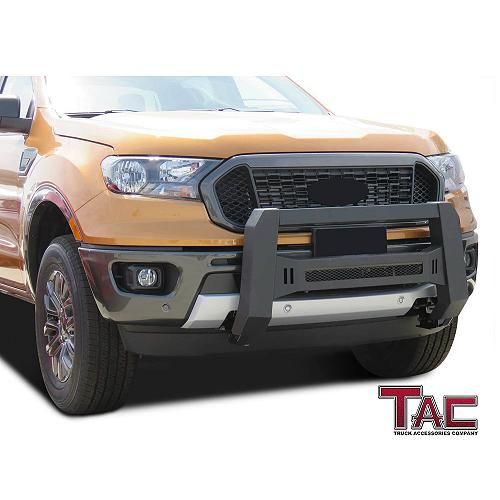

Just added a TAC modular Bull Bar, which claims to fit 2019-2021 Ford Ranger to my 2020 Ford Ranger. Now, the front sensors are going crazy, in fact, the vehicle is undrivable at this point because the sensors will not stop beeping. I tried turning off the Collision alert but that did not solve the problem. Any help or advise would be greatly appreciated.
Press the P )))) button located in same same switch cluster as the auto start/stop that should disable the parking sensors in the bumper
Can you post pictures? The reason I ask is because with those sensors now being a thing on Rangers, it may be an issue with others in the future.
It is possible that position and/or angle could be an issue as well. Since this is a new thing, it might take us a while to figure out what the fix maybe.
Of course, there is the issue that the angles and positions are hard set in these aftermarket bumpers. We may be figuring this out ourselves together.
