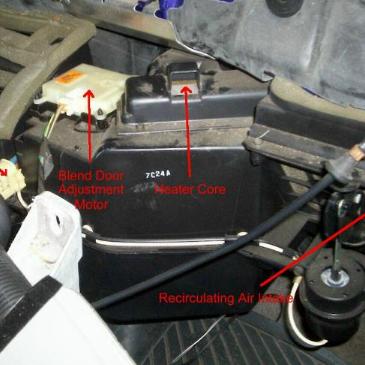

Yes, max ac works very well, even after the engine warms up. Everywhere else is hot. Where the air comes from does work according to the selector.
I guess that means it IS the blend motor or blend door, right?
The ticking I've been hearing, on and off for years.
Test it after removing? With 12 volts or continuity?
Unless the gear is just broken.

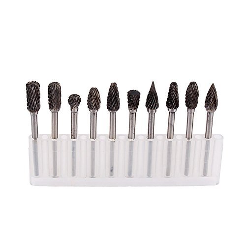

If your issue in the end does turn out out be the door then you'll need a dremel tool kit with a narrow routing tip to cut the hvac plastic.

I've gotta see what it takes to get the motor out.
^thin fingers.......lol
when I did this I used a short phillips screwdriver tip fitted into a speedwrench (7mm?) to turn the screws

I saw a youtube video of a way to cut the evap box enough to access the door. Showed how the clip on the lever breaks and the door will slide off of the lever.
I thought all the hvac doors were vacuum operated back then.
The vent doors are all vacuum but on 1993+ the blend door that separates the heater core from the AC evaporator core is controlled via an electric motor.
