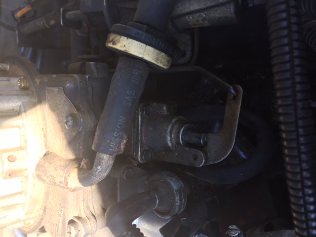

I recently installed a new accelerator pump, in the process I lost the stem out of the housing. I have so far been unable to locate one at the usual parts store. Any suggestions as to where I can find one?
I have pictures, can't seem to get them downloaded!

Looks like an autoline C8188 carb
Not usual Motorcraft 2100/2150 carb
Not sure if that part will be available as a separate piece.
Maybe look for old autoline carbs at wrecking yards, most are scrapped but you could get lucky.
Or just make what you need from wood or plastic dowel, drill one end and slot the other end
It doesn't need to seal anything it is on the back side off the diaphragm, the air side
