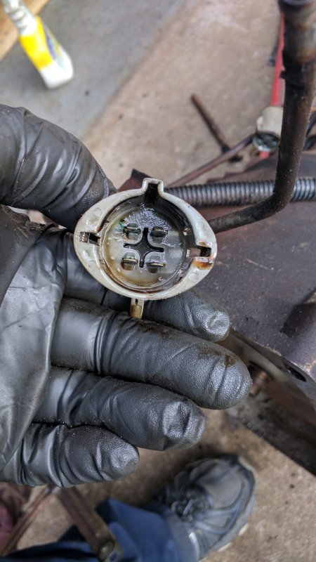

Hi all just got into the Ranger family. I picked up a couple of 1993 Rangers recently for me and my son. His truck is a 2.3L automatic 2wd. But the trans is bad, slipping and hard shifting when it does. I would rather not put the money into a rebuild just yet. I have done searched the forum and googled the A4LD. I am picking up today a 1986 Mustang 2.3L and Trans out of a good running driving car. Thinking the transmissions should be the same?
In my searching I learned that the trans I need for my 1993 Ranger is a 1985- 1994 A4LD (2.3L bell housing) because of the manual 1&2 and the electronic controlled 3&4th gears. It wasn't till after that I read somewhere that the Mustang and Ranger transmissions may have a different plug set up? Ranger having 3 pin and Mustang having only 2 pin. I think those plugs are attached to the valve bodies? If so can I just swap valve bodies?

The plug itself is attached to the case and needs to be changed along with the valve body. May also have to swap shifter linkage. If I recall the cars and trucks linkages are oriented in different positions.

Brad, The 86 Mustang A4LD trans only has a 4 prong plug?
That’s a C3 transmission in the picture not A4LD. The will not interchange. That is a 3 speed and the A4LD in the 93 Ranger is 4 speed.
Thank you for clearing that up for a Ranger Newbie Brad. Well craap now I'm back to where I started. I need a good used A4LD for the 93 or need to learn how to rebuild my transmission. Both seem rather hard to do. I even called 4 local transmission shops and none of them want to touch the older transmissions because of lack of cores and hard parts (if needed) and the cost is usually more then the vehicle is worth.
