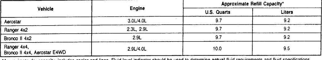

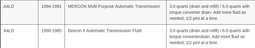

Hi guys , I see in the tech library that the A4LD box has a capacity of 6 quarts
54139
but in the atsg manual i find this
54140
10 quarts , can you tell me what is right?
3 quarts sounds about right for a simple drain/refill on a transmission that previous had the right amount of fluid in it. There is no torque converter drain plug so ignore that part.
10 quarts is accurate for a transmission that has never been filled before.
