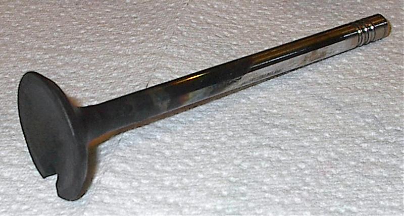

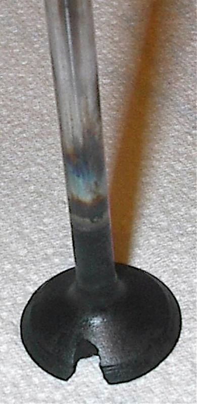

Okay. i finally got some money together to get my cylinder heads checked at a local machine shop, and it turns out one is cracked. All indications are that they have about 173,000 miles on them. The head gaskets have been replaced at least once before i got the truck with a bad one.
The good head has a burned valve that i've removed and need to replace, and it also needs to be resurfaced. What do you think i should do? i told the guy at the machine shop that i'd need a day to think about it, so if you could offer your opinion soon, that would be good. (i know you have opinions : )

For carnage sake, i got some pics of that bad valve too.
