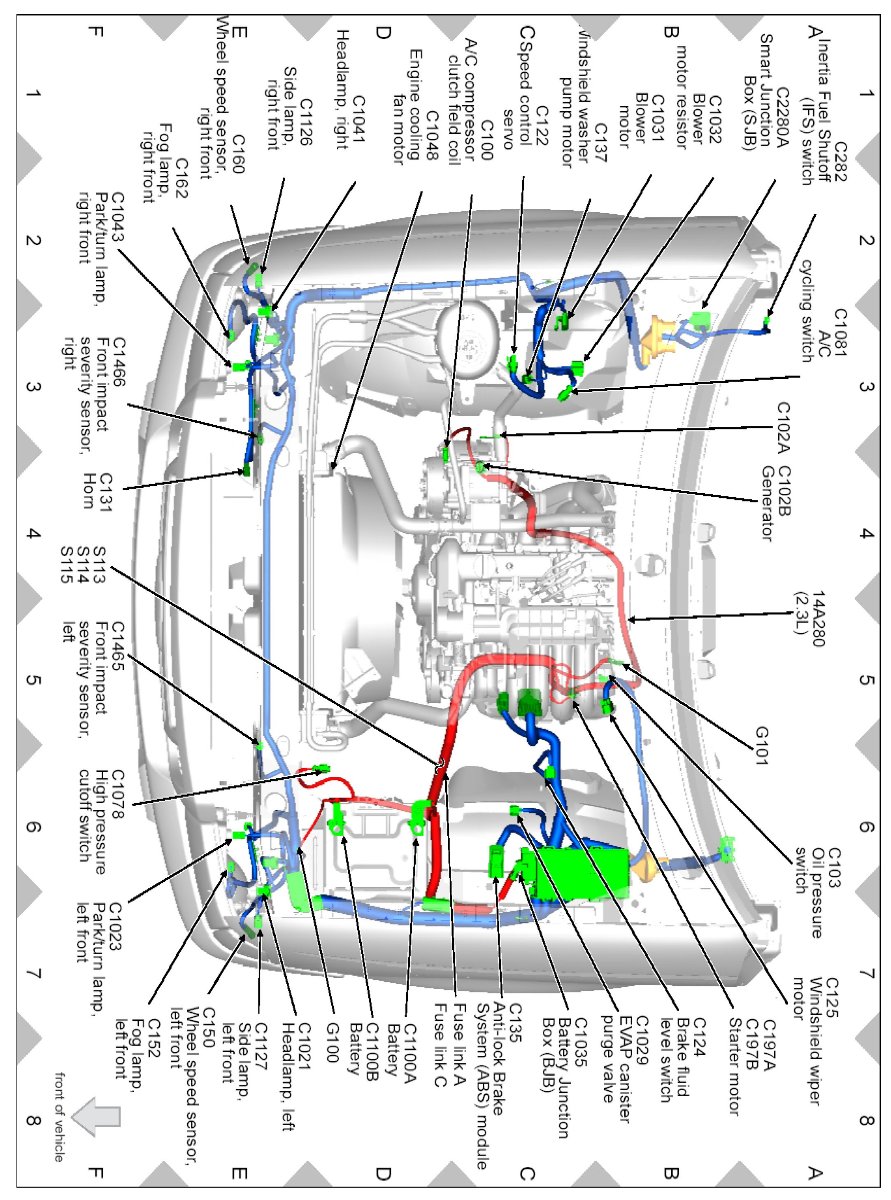

I see you have a blower motor speed resistor also, if I picked the correct model.
