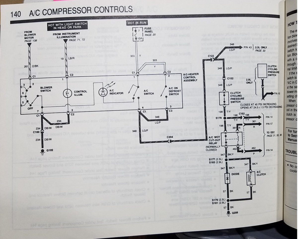

The ECM/computer controls the WOT relay by the signal received from the TPS. So, I can't see what could cause the problem you're having other than a malfunction in the ECM. Maybe someone else will chime in better info.
A quick fix would be to:
1) Remove the WOT relay connector from the relay and place a good jumper between the Black/Yellow and Tan/Yellow wires in the connector (WOT relay remains disconnected).
or
2) Cut either the Red or Purple wires on the WOT relay connector (and tape up the ends) leaving the WOT relay connected.
The Black/Yellow and Tan/Yellow wires (they should be larger gauge wires) are the 12 volt + circuit going to the AC clutch, so they need to stay connected. The Red and Purple wires (they should be smaller gauge wires) are positive and negative control wires from the ECM that energize the coil inside the relay. Disconnecting/cutting either wire will prevent the ECM from energizing the relay, which causes the AC clutch to disengage.
Personally, I would cut one of the relay's coil wires (Red or Purple) and tape up the ends. They can always be reconnected later. The only down side to this fix is that your AC will not shut off during WOT. But that's better than no AC, right? And you can always turn off the AC if you really need to get on the throttle.
Oh, and a "good" jumper would be (in my opinion) crimping a male spade terminal on each end of a small piece of the same or larger size wire as the Black/Yellow and Tan/Yellow, and then plugging them into the same positions that the Black/Yellow and Tan/Yellow wires occupy in the connector. Cutting the Red or Purple wire would be a lot easier.

Good work on finding the issue with the WOT relay activating with key on, but there may be a reason
Yes, red wire should have 12v key on, 12v is from EEC relay, just FYI
Purple wire goes to computer pin 54, its the Ground that would activate the WOT relay at full throttle
BUT......................With RPMs at 0 computer SHOULD ground pin 54 to activate WOT relay so AC is OFF for engine startup
So I would test that again with engine running, purple wire should not be grounded with engine running
If so then could be computer issue or purple wire has a bare spot and is grounded to another wire or the body

WOT relay is 5 pin, so when its off it passes 12v to compressor clutch if AC is turned on in the cab
If you press the gas pedal to the floor, so wide open throttle, the computer turns on WOT relay which cuts the 12v going to compressor clutch, shutting AC off, so engine can make best power for passing or ???
When foot comes off the gas pedal AC comes back on
