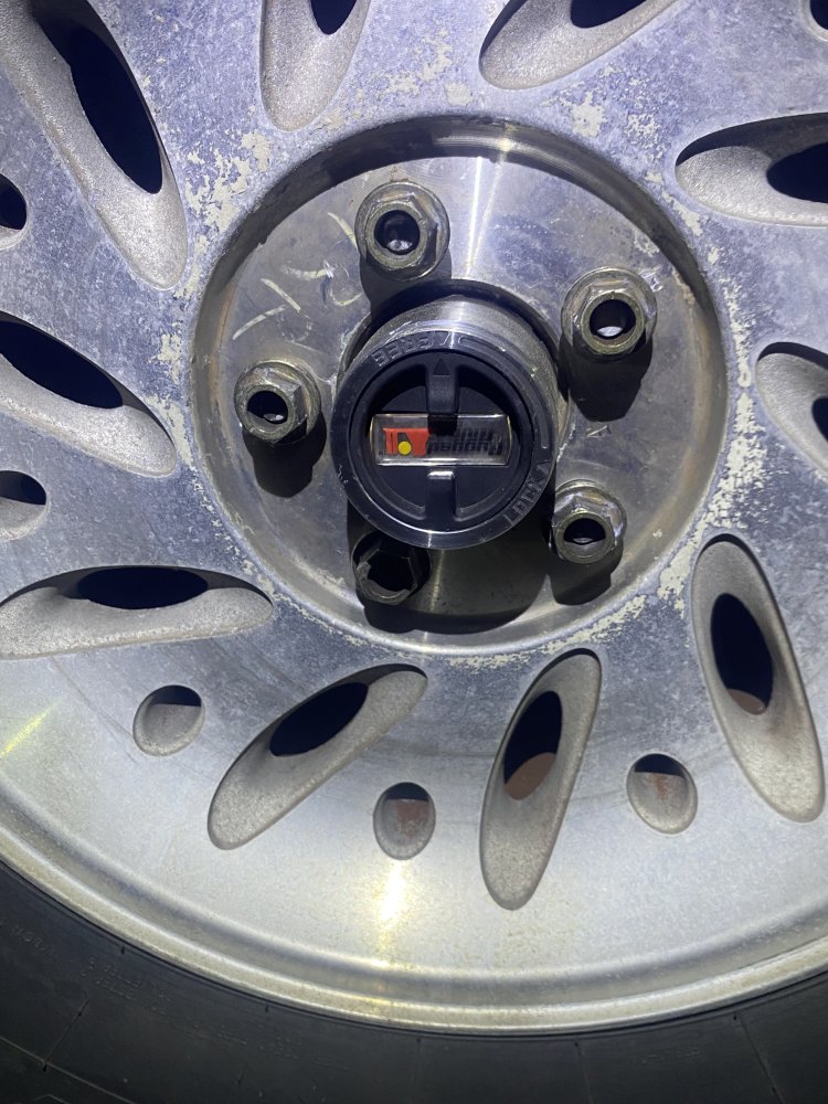

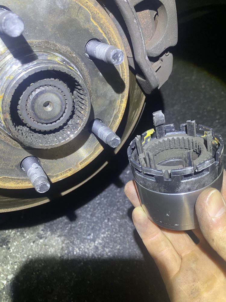

Here are pictures from today.

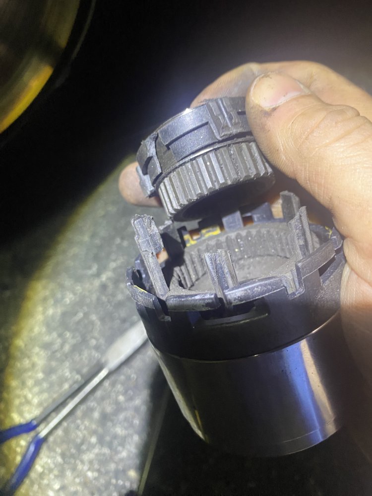

The new driver side's locking hub teeth have broken off and got minced to pieces...yet the passenger side one was still in tact, yet popped right off while I was getting going to remove pass. side wheel.
I can't add video for some reason but both axles are wiggling back and forth about an 1/8" or so inside the rest of the wheel. Even with the locking hubs installed.
I'll have to replace the driver's side one. I don't trust trying to epoxy those teeth back on to try and save it, unless y'all think it would work?
Not sure what to do next.
I remember the C clip that goes inside the axle's groove and prevents it from slipping out and through the wheel, but is there a second ring I'm missing?
Or is the axle I have somehow too long?

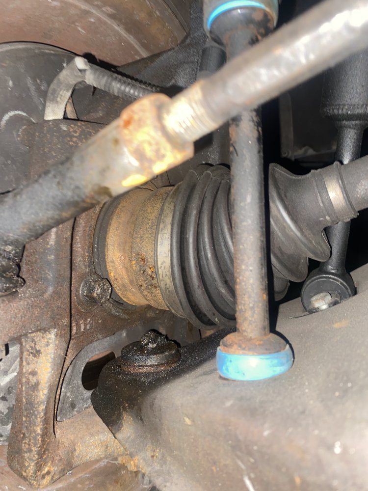

If the plastic insides of your locking hubs are breaking, they will keep breaking until you replace your CV axle. I have a write-up somewhere on the site about it, but that is the issue. Once the joints go bad, they overstress the hubs ability to keep them in place, and they break.
