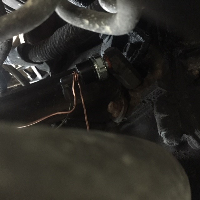

But that was with a brand new sender. Maybe I did my test wrong?

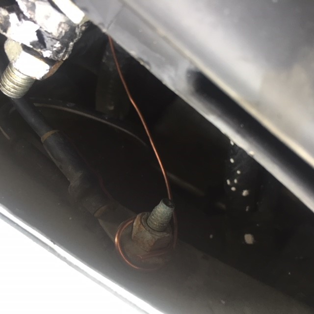

I wrapped a scrap piece of 12 gauge copper wire around the sender and the other end to the ground screw in the body of the car next to the common terminal of the the battery. I attached the electrical connector on top of the copper wire on the sender. Then put the key to the on position and the check gauge light went away.
I tightened that oil pressure switch on pretty good and it came with sealant on the threads. Maybe I need to tighten down more, or loosen it? Or i got two bad sensors?
That is very odd. All the tests point to a bad sender, but it is unlikely for two in a row to be bad out of the box.
Is this the correct way to ground out the wire?

Ground the metal part of the sensor. Perhaps it's not grounding correctly so when the switch closes the contact there is no ground to the terminal.
I'm questioning the engine's block connection to ground at this point.

It's hard to see in my last picture, but the metal contact point of the switch was grounded. I put the electrical connector right on top of the coiled wire. This test did turn off the check gauge light and spiked the needle to "normal" with the key in the on potion. However, once the engine is on, I'm having the same idling and smoking issue seen from the driver side exhaust manifold area. When I remove my added ground wire and turn the key to the on position, the check gauge lights illuminates and the oil pressure gauge sits at zero.
