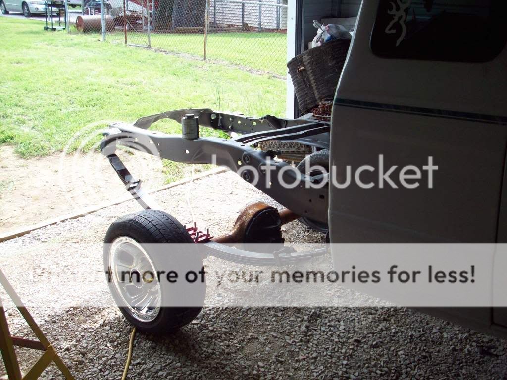

ok finally got some things done. its gettin hard to do anything by yourself. nobody ever wants to come help with the heavy stuff.

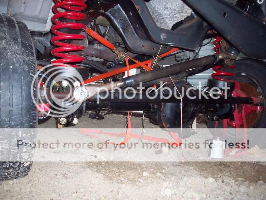

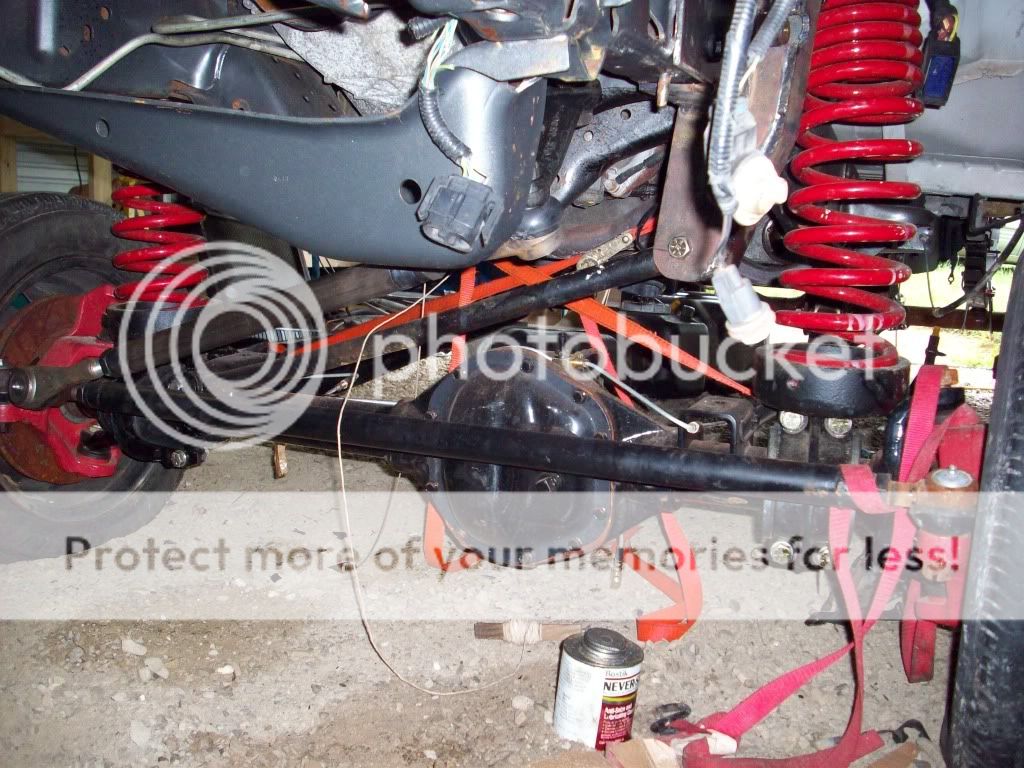

have the cab on and the motor is hovering over the mounts. once the engine is in place i'll figure out the steering and track bar angles and set the pinion angle on the rerar axle and get this thing out to the shop to weld everything up. hopefully this can all be done this week
any progress on this build?
yea i finally have the motor in and bolted down today. hopefully have it running and possibly moving on its own before the weekend. i have to get the tank in and figure my driveshafts out
doesn't look like much but i got a lot done yesterday and today

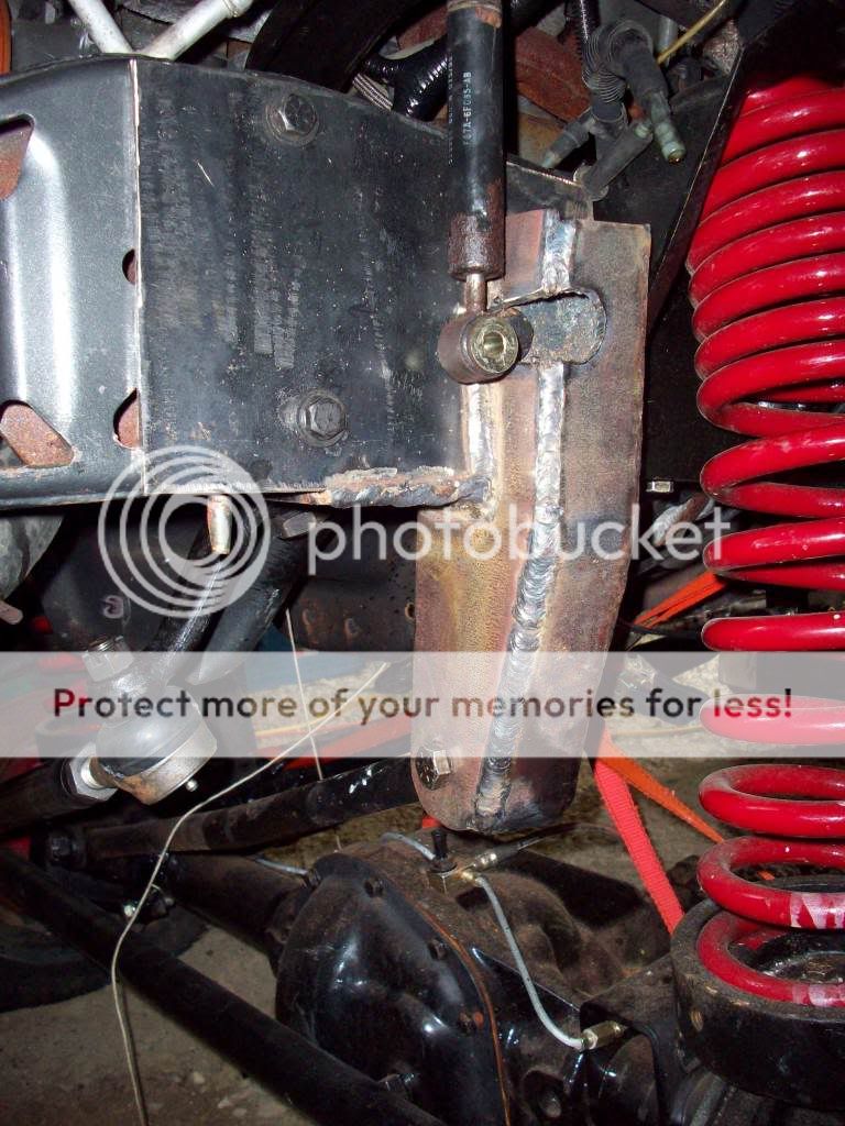

so i finally have the front end all buttoned up. i'm going to ad some more support to the trac bar bracket and maybe some more bolts. but other than that i think its done. :headbang:
i'm gonna be gettin back to work on this. i've been layed off all summer so money i did have went to bills. i'm back to work now so i'll be gettin back at it

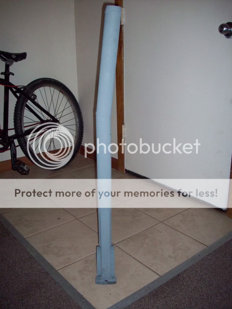

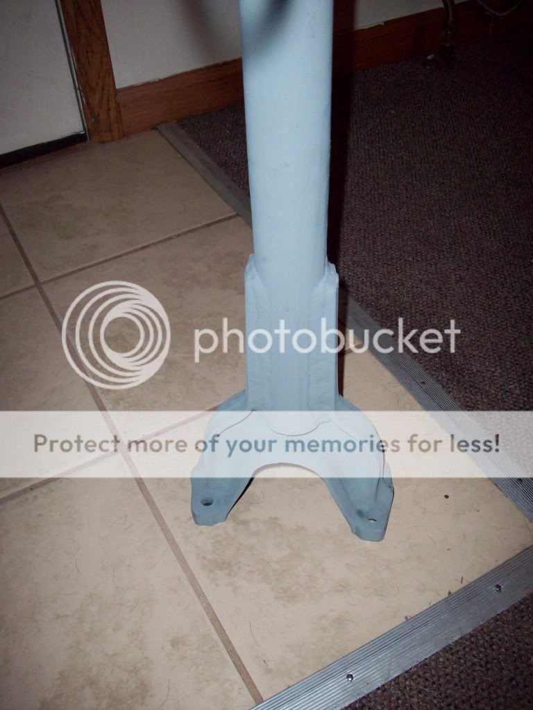

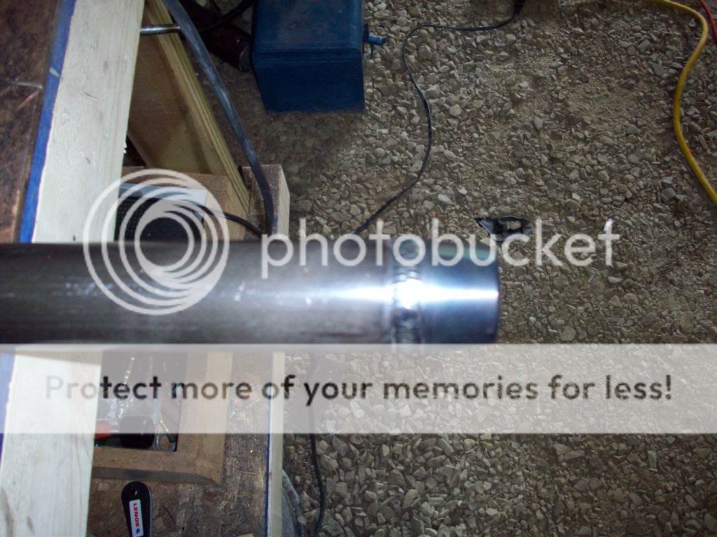

ok here is the first thing i got to. i wasn't happy how my first set of radius arms turned out so i made some new ones.. 2" .250 wall dom this time around about 30lbs lighter each and i put a bend in them to give me better clearance for those bigger tires.
old ones
new ones
