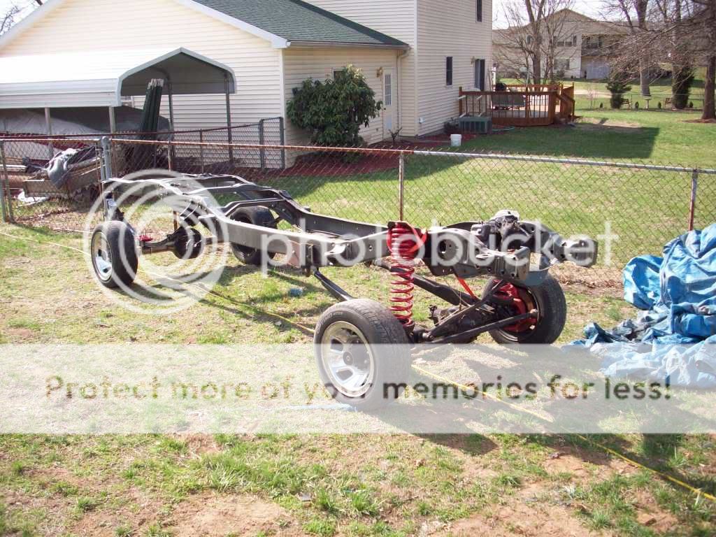

98 ranger crawler
thanks man yea its startin to come along nice now that i have a frame. i'll be mocking up the rear axle as soon as my softride chevy leafs come in

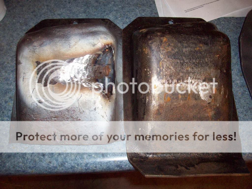

ok ran into my first little snag. i'm using the coil buckets of the 72 bronco frame and on the drivers side rail by the steering box looks like its going to need a little fab work to get them up in there. anybody have any solutions for this before i start cutting and welding?
some updates

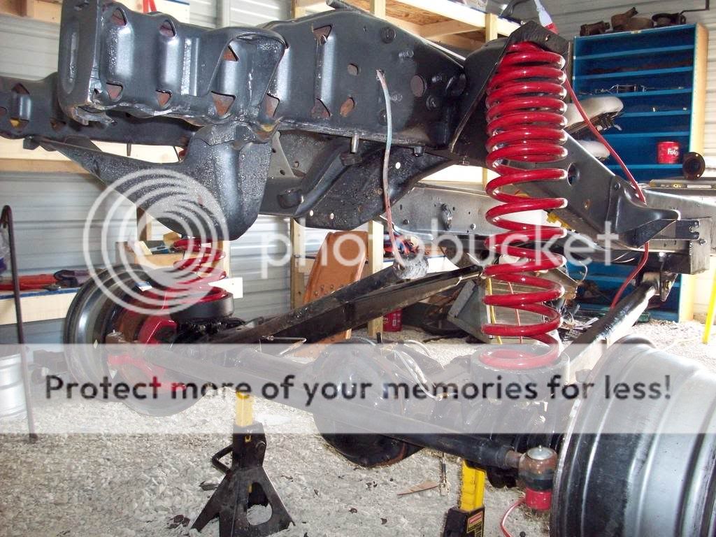

the front end is in and all thats left is track bar and upper steering link. i figured out my coil bucket situation, just cut, beat, and welded it.

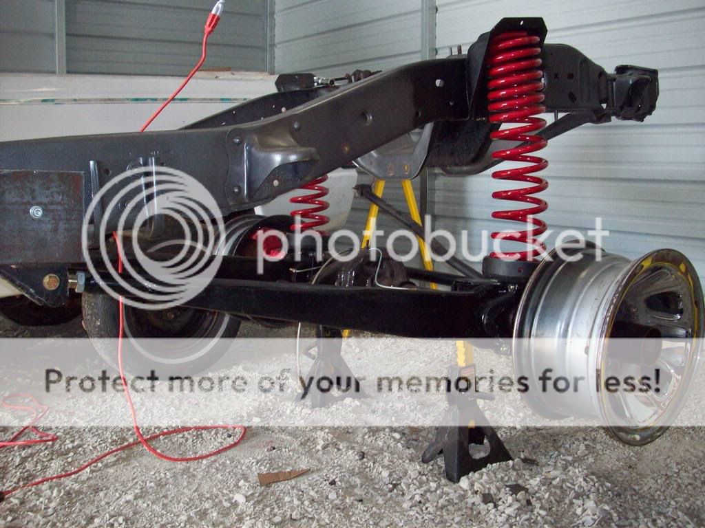

setting up for the chebby leafs. i am going with the procomp 5.5"

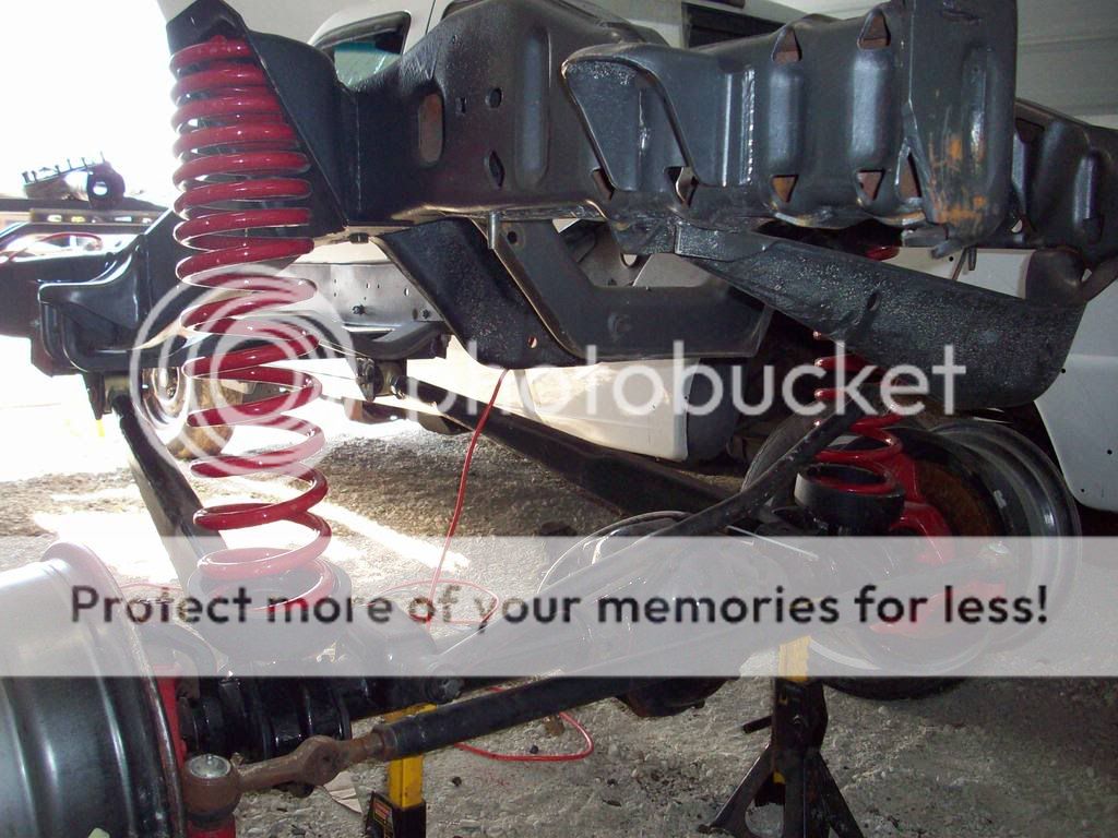

got the rear settin in there temporarely. i need new shackles. but i want to get it rolling so i can take it out to the shop and do some welding on it and then shoot it with some undercoating
the springs are the procomp 5.5" chevy lift springs
dude, i think your pinion angle is off a bit.....
haha, someone had to say it.
looks like its coming along nicely though
yea i was waiting on that. i'm going to get u bolts on monday and get it centered up and then put the motor and trans in and set the pinion angle and weld it all up :icon_welder:

where'd you get the 5.5" leaves? im trying to find the best deal...
4wheelparts.com they were 340.00 shipped that was the best price i could find anywhere and it looks like they are gonna be pretty flexy
