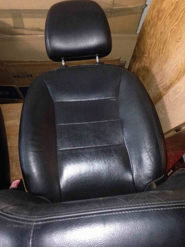

Here are a couple photos, but I'll post some better ones as I move forward. First one is just the seat. They are both heated seats if I can figure out how to hook that part up. The second photo is the bottom of the power driver's side seat and the last one is the passenger side.
