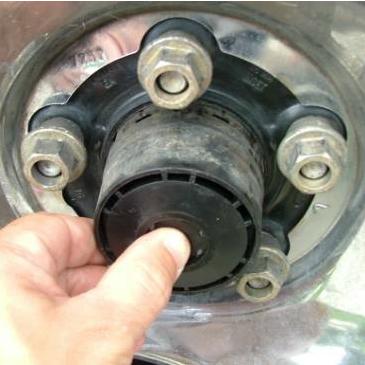

For sure. Though the jury is out on how much more reliable they are. Plus you can make the stock hubs manual by cutting the cover off of them and pushing the plunger by hand.
More info than you really need there.
If you just pop off that outer cover (first and second photos), you can cut the screen area out of it. Reinstall the cover and push through the hole to cycle the hub between locked and unlocked.
Thanks. That's exactly what I need until I can get the new hub locks installed.
Edit: well kiss my grits, this mod works great! The wheels I had came with steel hub covers so I drilled a small (1/4") hole to use a metal rod to press the plunger on the inside. It took a couple times to get used to how it feels engaged and disengaged but now I don't think I have much need to change out the hubs. I think this will work great for my purposes.
