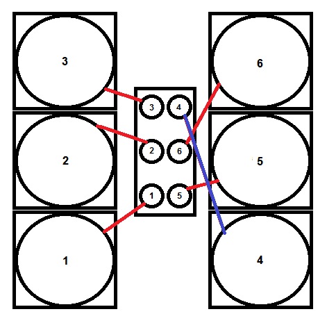

Recheck firing order on coil pack and then check it again, then have a friend check it, lol
[3 4]
[2 6]
[1 5]
The 5 6 4 side often gets a wire reversed
[ ] are matched pairs, its how the V6 engine is balanced, 1/5 are both at TDC at the same time, same for 2/6 and 3/4
That's why the wires are the way they are
Backfire means a cylinder misfired and the unburned fuel was ignited in exhaust manifold by the next firing cylinder, so you hear a POP
Thanks, I went out and checked it again. If this diagram is correct I have it right.

Wiring is correct in diagram
