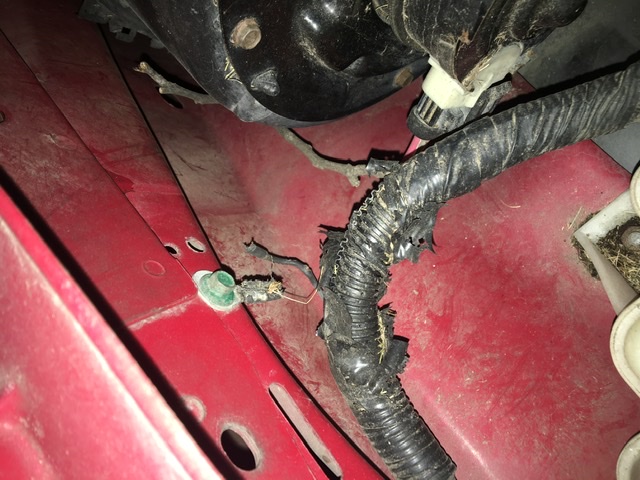

Well, after acquiring the correct schematic, I was able to start troubleshooting instead of changing parts. Turns out the problem involved damage to the grounding wire that serves the right front headlight and turn signal. Chipmunks got in my engine bay and caused havoc chewing on a few wires to include ground wire. I’ve attached a photo. Damn chipmunks!

That will do it...
This further confirms the "bad grounds and poor connections" theory even further.

Glad you got it figured out.... hopefully they didn't cause more damage elsewhere.
