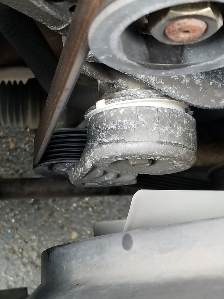

Look for squeaky tensioner pulley, idler pulley, alternator pulley, powers steering pulley, etc. Take the belt off. Rotate each item by hand. Wiggle them around and feel for play.
Well a bit of inspection today shows what could be the issue . Ordering replacement today. See where it seems to separate from the mount area

If you have an OHV 4.0 as opposed to the SOHC, it could also be the cam synchronizer, but I think you're on the right track with the belt tensioner. It does not look healthy.

Will replace tensioner tomorrow AM
Dont rely on an oil additive to "fix" things. You just masked a problem... fix it. I'm not a 4.0 expert but if it's like the 3.0s that thing drives the oil pump. Failure means loss of oil to the engine aka boom. Not something to be cheap about.
Replaced the tensioner.... old one was noisy off the truck but drove today and the noise is there still.
