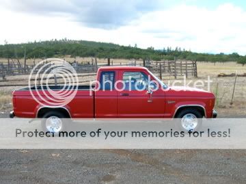

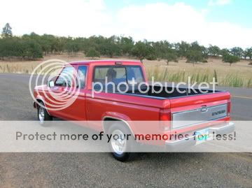

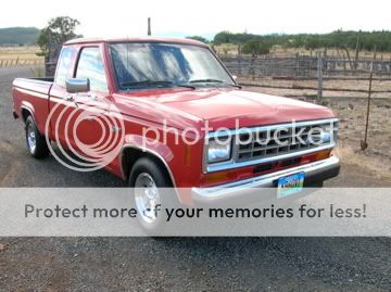

Here is how they turned out.
clean little truck. ive always been a fan of the "hoof print" wheels. just a nice design.
Does anybody know how to stop the "rattling" noise that is coming from the center caps on these wheels? Every bump I drive over I hear a rattling noise in quadraphonic stereo. they look great, but sound bad. Any ideas?
