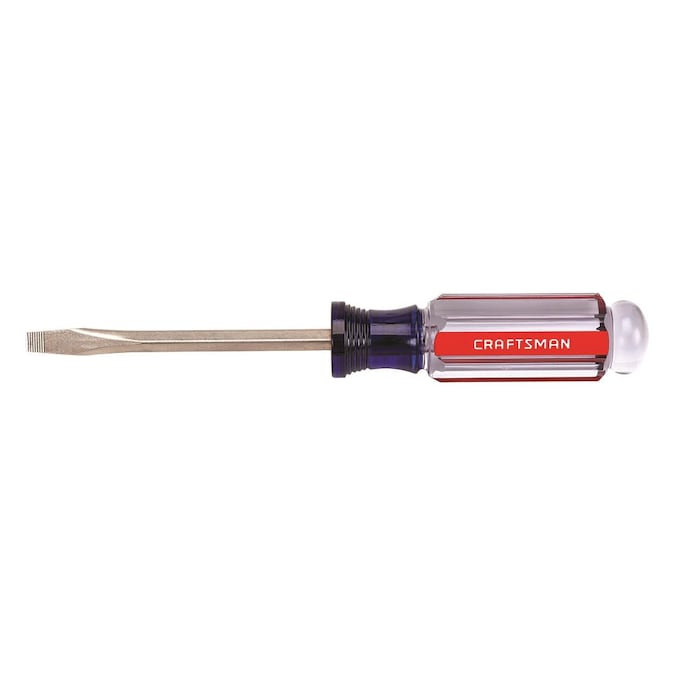

I usually just hammer this style screwdriver into the ign. switch:
65084
Then turn it with a large adjustable wrench. Then you can remove the switch like normal and replace it.
