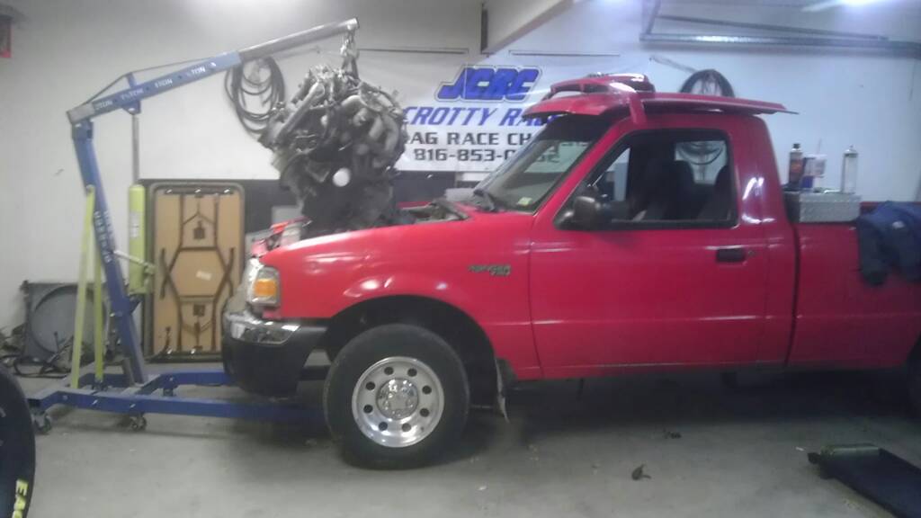

If needed it can be pulled with the trans.
This is a 2.5 2wd, but as you can see it requires some serious angle and lift to get it out.
