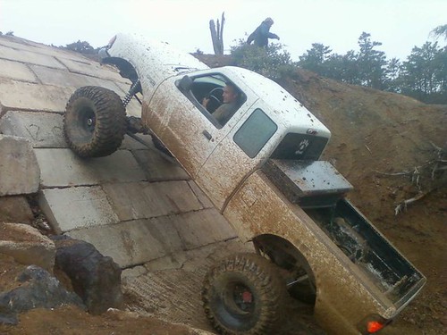

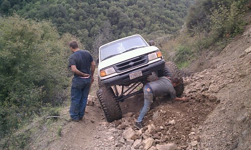

sooo...had to replace a steering box, add an assist ram, and do some other misc stuff to my buddys chevy before we were able to head out for the day. everything was going well, until i attempted what looked like a pretty long, rutted up, but easy enough hill climb in 2H. ended up breaking the welds on the spring perches, and the pinion angle got sent up to the point that the yoke ubolts got pinched between the yoke and driveshaft. ended up headin back to a friends house that was in the area, welded it all up, burned it in really good this time, then headed back out. wheeled really good for the rest of the day til we went to the 'obstacle course'. attempted the concrete wall at cow mtn, and about halfway up the rear shaft spit out the u joint at the axle. broke two caps, but had another ujoint. kept wheeling, then after a few hard hits coming off ledges and rocks, i heard some sort of leaking air or something then the truck started running like crap. opened the hood to find a huge hole in the top of the plastic intake manifold from the coilover crossemember. i thought 1/2" was enough clearance, but guess not. now i have to get a new intake, build an anti wrap bar, and do some other stuff...oh well, it was fun.
