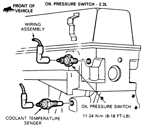

Now you have me second guessing myself, lol. No plastic connector. This is the threaded stud push on 1 wire connector. I'm gonna work on it tomorrow so I'll take a pic and post it. FWIW it's on the cylinder head right next too the intake manifold runner so I assumed it was water temp. I'm aware of the two sensors on the water passage pipe at the front of the motor.
I recently pulled the motor and replaced all gaskets/timing belt, etc. and got the motor back in. The temp gauge never worked so I assumed it was a bad sender and I tossed it when I pulled the motor. Wish I hung on to it so I could have measured the thread size.
OK, here is a pic. I took a better look at the hole this time. It is an oil passage and the wire is red with a white stripe. So i got a new oil pressure sensor and screwed right in. The ensuing story is how this started. It should make you laugh. This is my 19yo son's first car, 97 B2300 I picked up for $1,700 bucks.

Yes the oil switch/sender is in the head
temp sender is lower and in the block, looks like it has a hex plug in it blocking it off

Yea, there is a hex plug there. Gonna leave as is because I don't have a wire in that area to connect anything. The temp gauge never worked. So eventually I'll replace those sensors.
