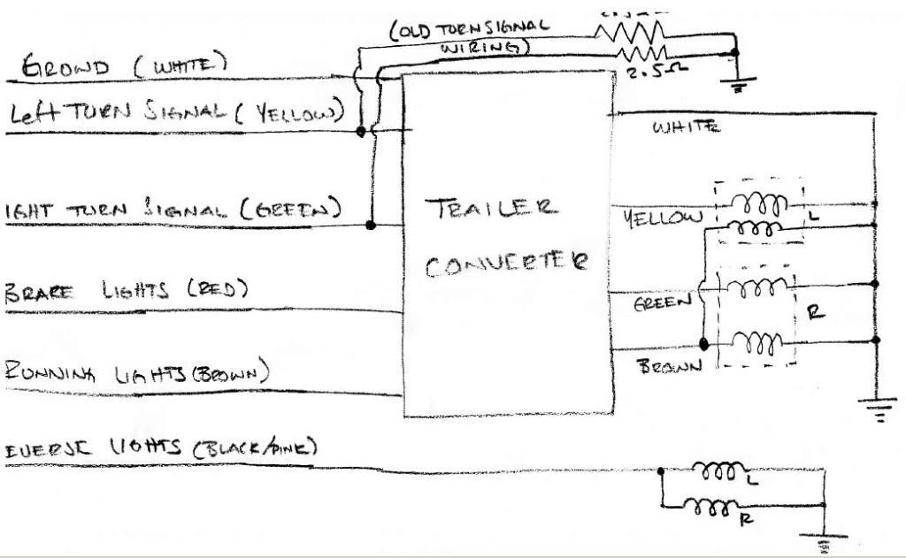

...I must have read every post in this forum related to taillights conversion problems.. I was about to quit last tuesday when I decided to send an email to Hopkins mfg saying I had problems with my "trailer".... this is what I sent them:
Message:
Hello, I have recently purchased a Hoppy 48925 Taillight converter to hook up to my 1994 Ranger. The problem I have is that when hooking it up to the vehicle the running lights and turn lights work fine, but the brake lights dont work. Being a 94, I have separate lights in the truck and my setup in the trailer is a combined brake/turn lights signal. In case it helps to troubleshoot this problem, if I ground turn lights inputs in the converter the brake lights work. I have also hooked up a Hoppy 48845 converter with the same results. Thank you, Id appreciate any support you can give me with this problem.
and what I got back from them:
Converter will only work if you have it hard wired in completely.
You are using to tow a trailer and not to change the taillight system on the car, right?
They must get a ton of ppl asking for the conversion :icon_rofl:... anyways, I just went around the issue for three days and yesterday morning it struck me.. the guy said the converter would only work if it's wired completely and I was mentioning that grounding the turn light would make the system work (which I stupidly thought it meant the box was screwed up or it just wasn't made for the way the truck handled the turn signals)... Conclusion? The damn thing is made for trailer lights!!! Meaning it's being hooked up in tandem to the truck's lights system!! If the ground in the system is floated (i.e. wires cut) the box won't work.
Solution? you need to fool the box into thinking the system is still there. Given that I was getting rid of the old turn signal wiring, I just kept them and instead of a light bulb I bought a couple of 2.5 ohm resistors from RadioShack to simulate the bulbs so I wouldn't have an extra thing to worry about. Frikin' thing worked and me have lights now!!! Celebrated with a friend with a 6-pack of MGD :icon_cheers:
Here's a diagram:
I really don't know why my setup was different than the one in the tech section, but the way I set it up follows the logical thinking that the box is supposed to be hooked up to a working system, not used as a "stand alone unit", if you will... I might be worthwhile to put this in there as a side note...
