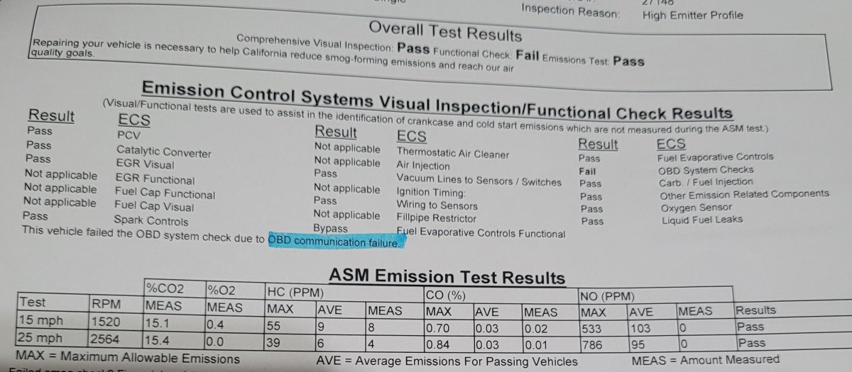

Will pass except the reason highlighted in attached image in this post. My bosch obd scan tool to clear codes and check codes works. My cigarette lighter for charging also works. Not sure where to even start except some quick generic searching ive done via google.

Went to do my free re-test, it failed. Went to a shop where they cant smog it because it requires a shop that has dyno testing here in CA, he connected it just to see and it communicates fine.
Going to another shop that is able to test the car today or tomorrow hopefully, just want this nightmare over. Wasted 72 fun bucks, if it passes ill file a complaint with the BAR of faulty equipment.
Ok so update, took it to another place, the first smog check clearly shows my RPM on the readout at 15 and 25 MPH tests. My two scan tools both show real time RPM readout as well as other info.
The guy failed it (third attempt, 2nd shop first visit), said it wouldnt hold a connection and said inconsistent RPM reading. Driving half an hour around town today my scan tool never had an issue reading RPM, or disconnecting. I made an appointment with the referee to speak on Wednesday.
