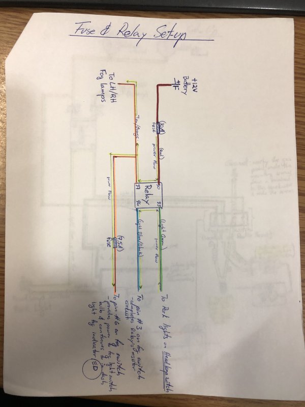

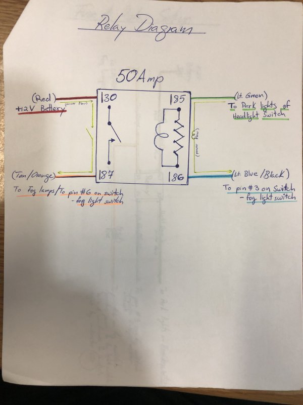

What he did was building this fuse box with one 50A relay and 2 mini fuses, one for the main feed from the battery (30A) and anotherone for the interior switch (7,5A). This way the system is protected on both ways; the “main” feed from the battery and the “secondary” to the switch inside the cab.
This is the fuse setup:

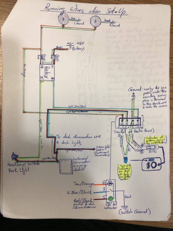

This is the main setup layout:
96 OEM Fog light installation
I run all my wiring (GLX high temp. wire) inside corrugated plastic tubes, this gives a nice clean installation and also protects all the wiring.
3.1- Run the main Red thick wire to the battery tray area
3.2- Run the Thick Tan/Orange to the front bumper area
3.3- The rest of the wiring (thin Tan/Orange), Green/Lt. green and Blue/black) should be run together to the inside of the truck trugh the firewall. Theres a perfect spot on the brake pedal area; just notch this rubber grommet and feed al the 3 wires together to the inside of the truck.
3.4- Once the 3 mentioned wires are inside the truck, the tan/Orange and the Lt. Blue/black will be routed to the radio area (to the switch), while the remaining Green/Lt. Green will be routed to the main lights switch.

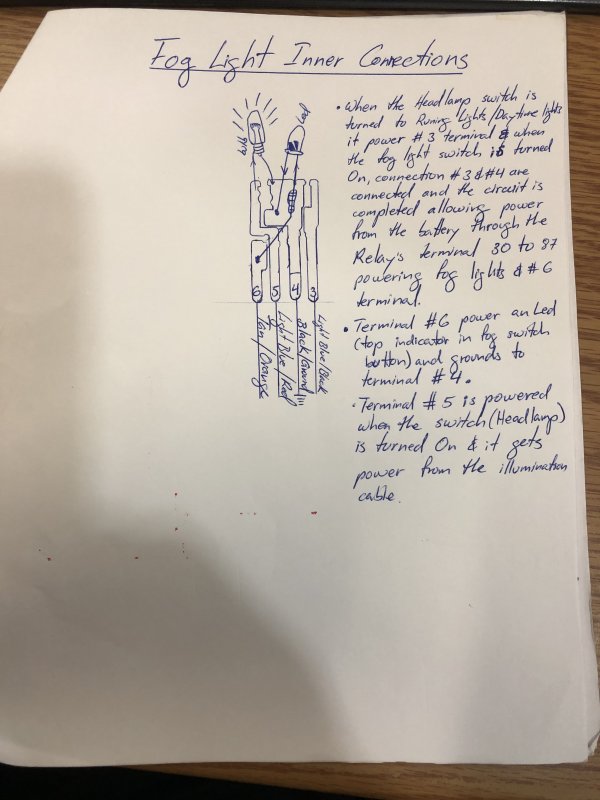

3.5- The last wiring will be from the fog light switch to the main light switch, to feed the "instrument panel illumination".
3.6- Connect the Green/Lt. Green wire to the park light wiring on the switch (this changes over the years, please check your own).
3.7- Connect the Red/Black wire to the dash illumination wire, also on this switch. Run this wire to the fog light switch on the radio bezel.
3.8- Plug in the fog light switch
3.9- Run the think black wire from the switch to a ground spot. Theres a very nice spot for the ground nearby the gas pedal; undo the mounting screw, place a terminal in this black wire and redo the screw.
To sum up the interior installation; we ran 3 wires from the engine bay; one went to the main headlamps switch (green/lt. green) and the other 2 run to the fog lights switch (Lt. Blue/Black and Tan/Orange).
